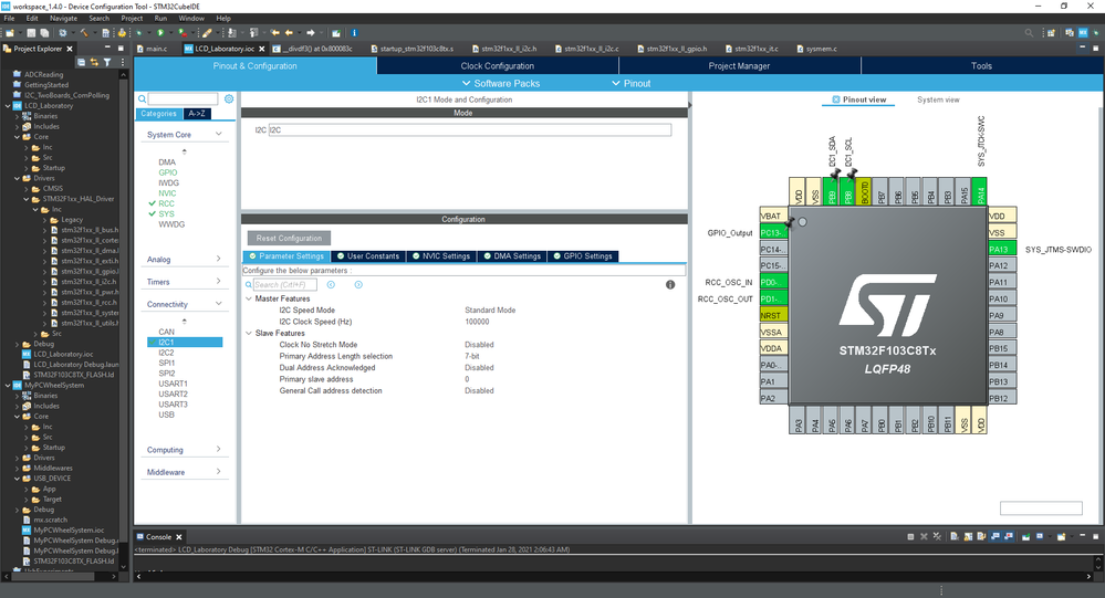

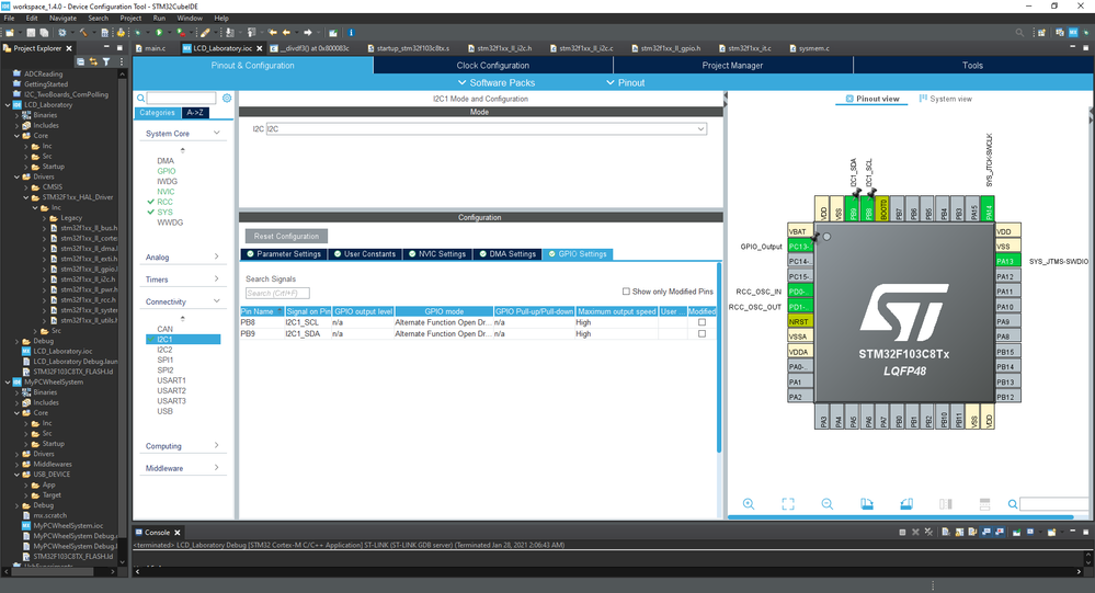

I have troubles using I2C with the STM32F103C8T6 "Blue Pill" board. I set up the code in CubeMX, using LL Libraries.
After initializing the I2C periphery I try to send the address, but the ADDR bit in I2C1_SR1 register remains 0. AF bit remains 0, too. I checked it by debugging and observing the registers. At the moment right before the function call "LL_I2C_TransmitData8(...)", in SR1, everything is 0 except SB, and in SR2 everything is 0 except BUSY and MSL. After this function call, SB becomes 0. After that, ADDR remains 0 and the program stucks in the while loop.
I could not find any solution to this problem neither on the internet, nor in the errata sheets.
I tested the I2C-LCD with an AVR Atmega328PB, works perfectly there. It's a 16x02 LCD with a PCF8574T 8-bit-to-i2c expander.
I am sure everything is connected properly: GND to GND, VCC to 5V, SDA to PB9, SCL to PB8. Also tested the contact with a multimeter.
Unfortunately, I don't have an oscilloscope or logic analyzer.
Here is my setup in CubeMX:
0693W000007CxxTQAS.png0693W000007CxxYQAS.pngHere is the code:
