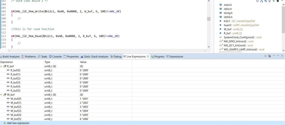

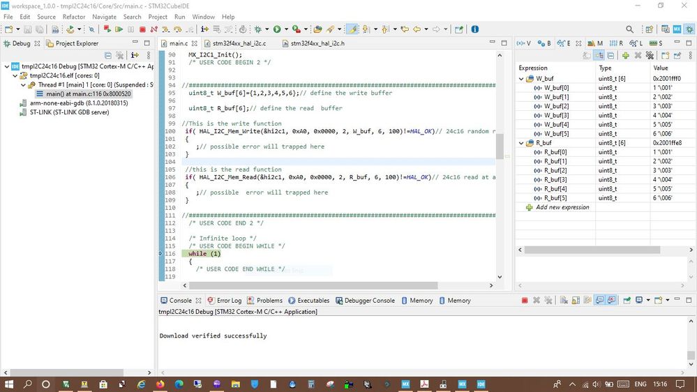

Hello
This is a working example made for this purpose.
Dont forget the pullup resisrors.
Here is the code
 uint8_t W_buf[6]={1,2,3,4,5,6};// define the write buffer
 uint8_t R_buf[6];// define the read buffer
//This is the write function
 if( HAL_I2C_Mem_Write(&hi2c1, 0xA0, 0x0000, 2, W_buf, 6, 100)!=HAL_OK)// 24c16 random rwrite at address 0.
   ;// possible error will trapped here
 //this is the read function
 if( HAL_I2C_Mem_Read(&hi2c1, 0xA0, 0x0000, 2, R_buf, 6, 100)!=HAL_OK)// 24c16 read at address 0.
MS.11
Thank you soo much.
MS.11
Thank you sir. I tried as u told it is working but in R_buf the values are not storing. I don't know what to do. Plz help me sir.0693W000007CnDVQA0.jpg
