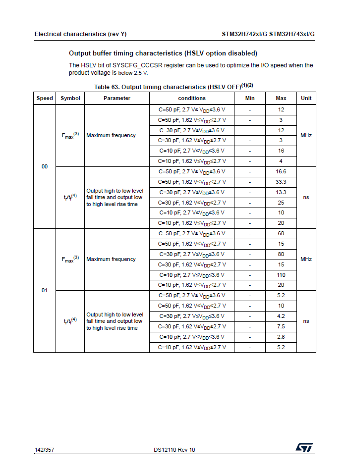

I would like to know about the 4 GPIO speed settings on the STM32H743BIt6. And is it possible to measure the system clock 400Mhz from the MCO2 pin output terminal?

#define GPIO_SPEED_FREQ_LOW     (0x00000000U) /*!< Low speed   */
#define GPIO_SPEED_FREQ_MEDIUM   (0x00000001U) /*!< Medium speed */
#define GPIO_SPEED_FREQ_HIGH    (0x00000002U) /*!< Fast speed  */
#define GPIO_SPEED_FREQ_VERY_HIGH  (0x00000003U) /*!< High speed  */

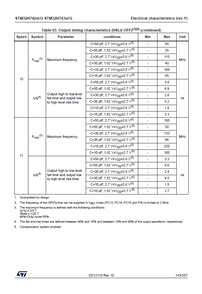

I would like to know the maximum frequency of each.

Check the datasheet / reference manual about the GPIO speed settings. These are register settings, so you will find a description.

I see maximum speed 220 MHz
