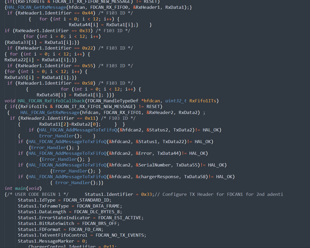

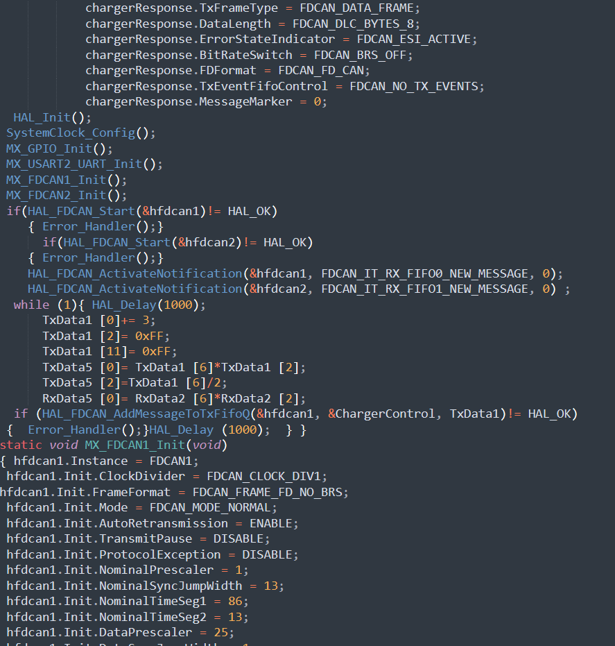

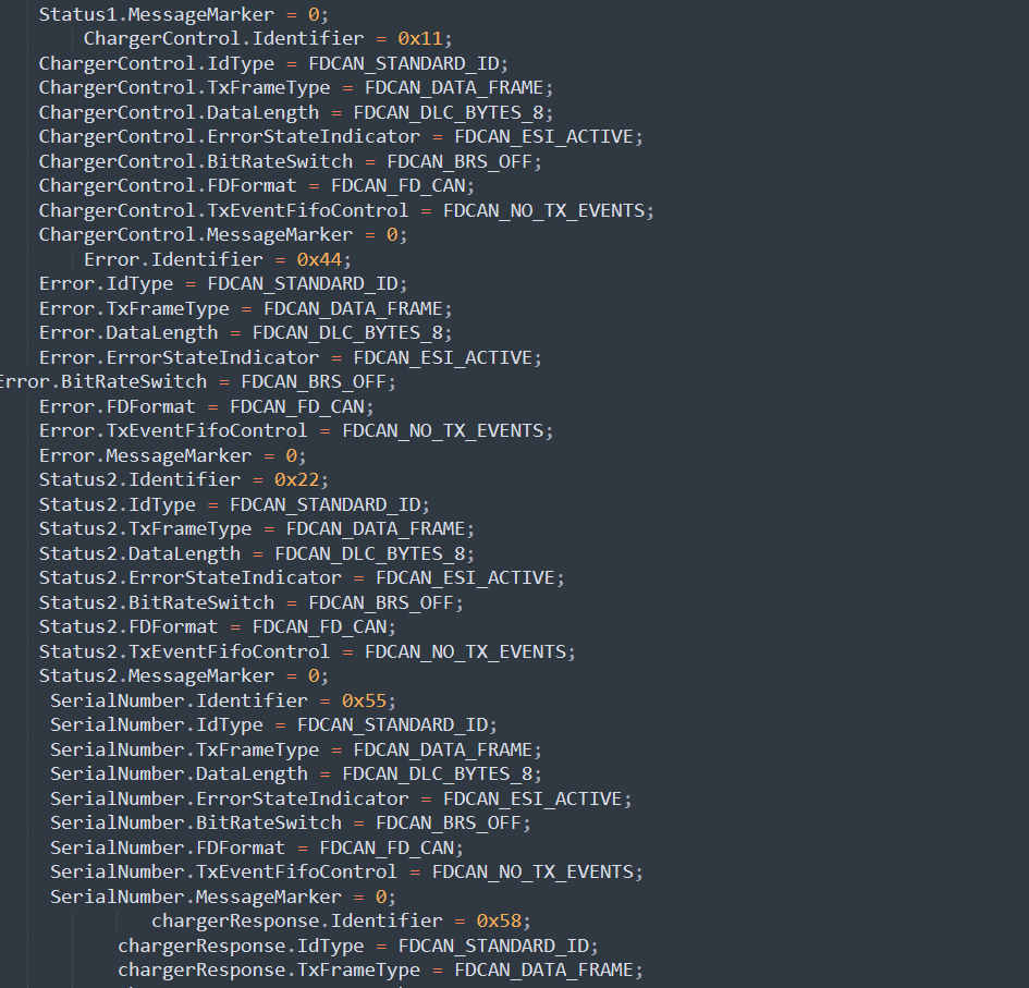

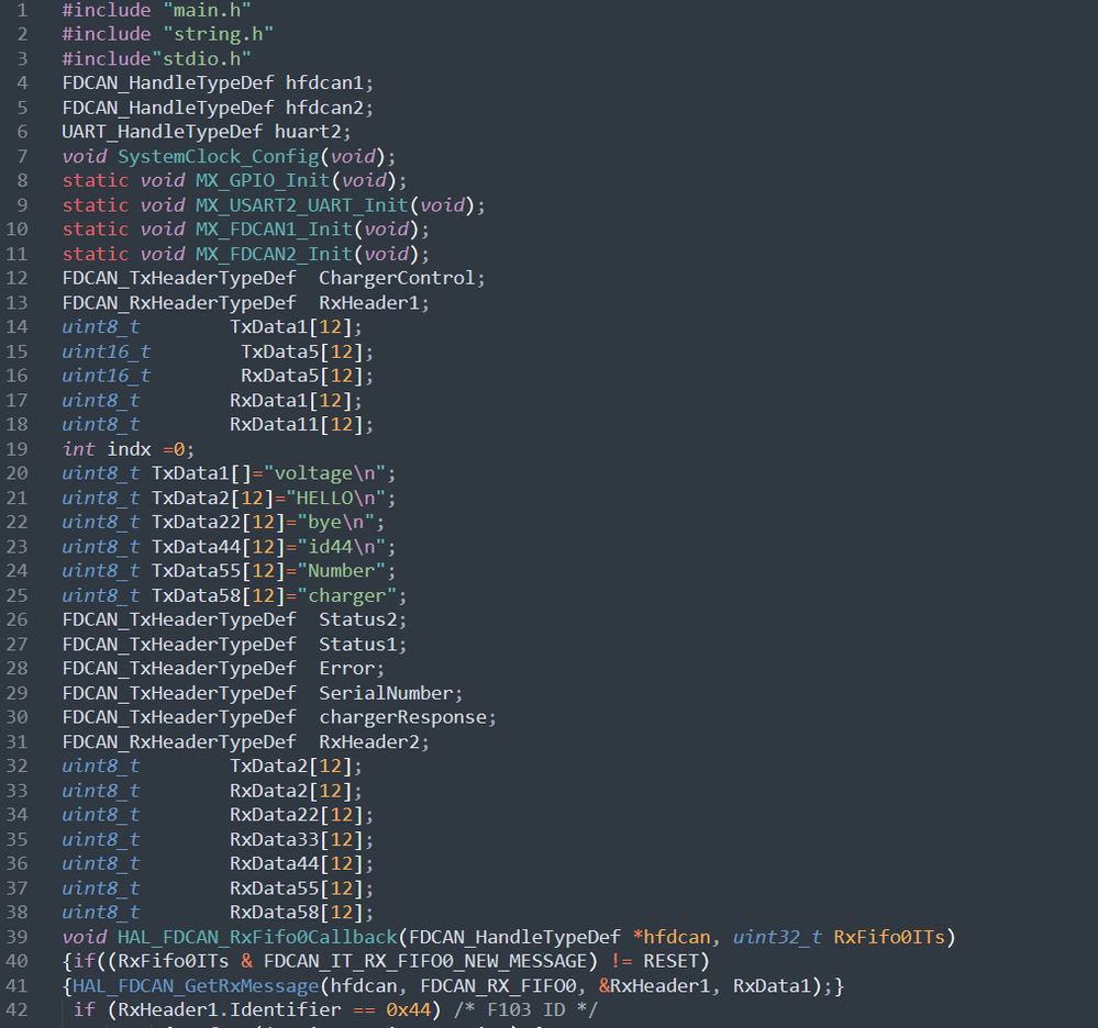

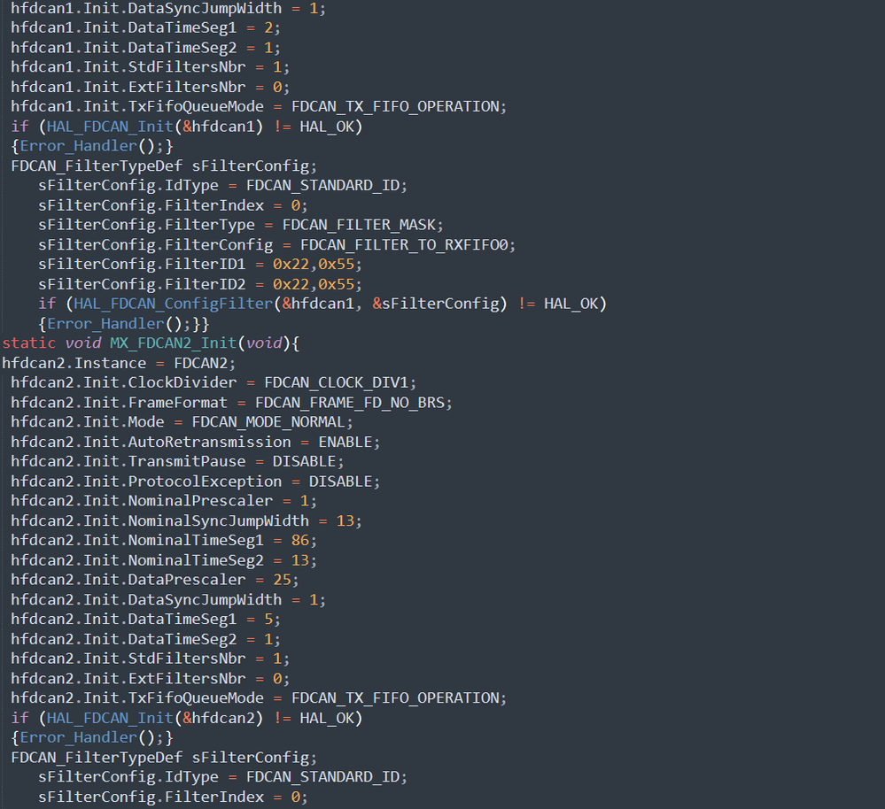

how to send 5 frame in fdcan protocol ?
Ranjeet Singh
Senior
i am able only send 3 frame but i want send 5frame ,what i am doing wrong ?
_legacyfs_online_stmicro_images_0693W00000bjZBqQAM.png if (HAL_FDCAN_Init(&hfdcan2) != HAL_OK)
 {Error_Handler();}
 FDCAN_FilterTypeDef sFilterConfig;
  sFilterConfig.IdType = FDCAN_STANDARD_ID;
  sFilterConfig.FilterIndex = 0;
  sFilterConfig.FilterType = FDCAN_FILTER_MASK;
  sFilterConfig.FilterConfig = FDCAN_FILTER_TO_RXFIFO1;
  sFilterConfig.FilterID1 = 0x11;
  sFilterConfig.FilterID2 = 0x11;
   if (HAL_FDCAN_ConfigFilter(&hfdcan2, &sFilterConfig) != HAL_OK)
  {   Error_Handler();}}

LCE
Principal II
Your mix of screenshots and code really s*cks...
Anyway...
I guess your TX FIFO queue is filled up and won't empty because the CAN messages you sent are not ACK'd by a receiver.
Have you checked with a scope what's happening on the CAN bus?
I'm not a fan of the presentation method. There is a Code Format tools for pasting code, see </> icon, or attach .ZIP file
Not really looking to debug FDCAN code.
Suggest you check FIFO depth, and if the prior messages were sent yet, or if you need to implement a queue and send new packets in the callback.
Piranha
Chief II
If you make million copies of the same code just because you do not know how to use pointers and structures, it means that you have to learn the basics of software development first. Making complex systems without understanding the basics will never succeed.
LCE is correct. You have a 3 message mailbox, without and ACK that buffer stays full. You have 2 choices, purge the mailbox or put the CAN peripheral in Loopback mode.
