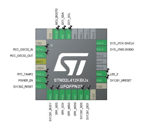

I'm working on a project with an STM32L4 microcontroller and I need to implement an anti-tampering function to detect if the case has been opened using a switch. I know that the STM32L4 has an anti-tampering function on pin PA0, but I'm already using this pin as an input for the clock of a radio (SX1250). What are my options for implementing this type of anti-tampering function in my device without interfering with the radio clock input? Is it possible to use a switch to detect tampering, and if so, how could I do it? I appreciate any suggestions or advice you can offer.

_legacyfs_online_stmicro_images_0693W00000bjrAvQAI.pngIt is the STM32L412KB, I think I only have the PA0 available
Ah... ok. So I have no idea.

waclawek.jan
What does that mean? Is it necessarily connected to PA0, cannot be it connected elsewhere?
The TAMPER input provides a particular functionality: timestamping and backup registers reset, even in VBAT mode (i.e. when there's no power on VDD only on VBAT). However, on the 32-pin package, you don't even have VBAT pin.
So, define, what exactly do you mean by "anti-tampering function". Maybe you just need to wake up from some of the low-power modes - for that, decide, which low-power mode do you intend to use, and read the PWR chapter in RM to see your options.
That is something I was wondering too. I am following a reference design and it uses the PA0 as an input pin which is connected to the output clock of the radio module. I assumed that it might be utilizing the PA0 as RCC_CK_IN to synchronize clocks? so I guess that it has to be that pin and not a normal GPIO but I am not sure.
I am looking for a way to alert the user if the device's case has been opened, even when it's not connected to power. I don't want to use any irreversible because the device should continue functioning normally. The goal is simply to inform the user that the device may have been tampered with.
