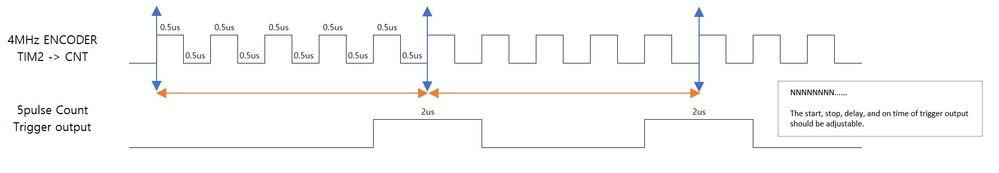

I want to generate ONE PULSE TRIGGER by comparing the encoder counts input from 2MHz to 4MHz and setting the delay time and duty.
rm.1
hello.
Currently on TIM6
void HAL_TIM_PeriodElapsedCallback(TIM_HandleTypeDef *htim) is used and trigger is generated using the toggle function of general GPIO.
After comparing the encoder pulse input from 2MHz to 4MHz with a period of 5pulse (10us), accurate on-time trigging of 2us is required.
(2MHz input: 1 pulse per 2us)
(4MHz input: 1 pulse per 1us)
So the toggle function of general gpio with delay and offset cannot be used.
Any advice on how to fire an adjustable one pulse trigger after comparing tim2 -> cnt ?
If there is another way, I'll work **** ** it.
thank you
BOARD: NUCLEO-F746ZG (max 216MHz TIMER CLOCK)
IDE: STM32CubeIDE (Version: 1.10.1)
tim2 : HAL_TIM_Encoder_Start(&htim2, TIM_CHANNEL_ALL);
tim6 : HAL_TIM_Base_Start_IT(&htim6);

I don't quite understand, what are you trying to accomplish. Try perhaps to draw a timing diagram.
JW​
rm.1
0693W00000UFPXUQA5.jpgThis is a block diagram that requires trigger control.
thank you​
waclawek.jan
OK so if I understand it correctly, you need to count pulses within a period, and if there were more pulses than a threshold (i.e. higher input frequency), you need to output a pulse.
The "if there were more pulses" unfortunately implies some processing which has to be done by the processor, so I don't quite see a way how to do it purely in hardware, without interrupts. Sorry.
rm.1
Thanks for the reply.
How about using HAL_TIM_PWM_Start_DMA to output trigger after counting 5 pulses without using the usual gpio toggle?
I think HAL_TIM_PWM_Start_DMA allows you to adjust the start, stop, delay, and on time of trigger output.
However, since it has to be performed within a time base interrupt, it is not accurate whether it will operate in synchronization with the rising edge.
