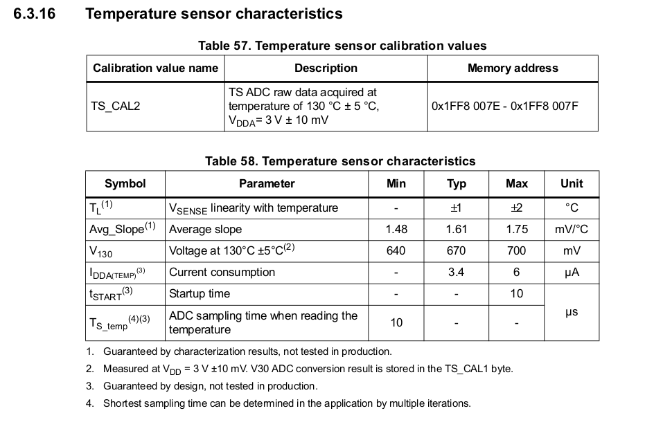

I would like someone to confirm that the temperature I am getting is somewhat in the ballpark to be expected. If it isn't, could someone check my values that I am using from the datasheet?
I am currently getting 11 C which seems low for ambient room temperature.I know that the ADC internal temperature measures junction temperature. I expected +/- 5 C swing, not -14 C.
I can also confirm my ADC is working with DMA as I am using it to read internal voltage and various other analog measurements.
For this particular micocontroller, the values are taken off the datasheet and are designed to spec:
I am usingthelow level driver function to determine temperature:

My Code:
// Values derived from datasheet STM32L011x4
#define ADC_TEMP_AVG_SLOPE 1610
#define ADC_TEMP_TYP_CALX_V 670
#define ADC_TEMP_TYP_CALX_TEMP 130
#define ADC_TEMP_REF_VOLTAGE 3300
int16_t adc_get_temperature_internal(void)
 // Get Active Buffer (Opposite End of What the DMA is Filling)
 // Covert Values Into a Voltage.
 if(adc_active_buffer)
 return __LL_ADC_CALC_TEMPERATURE_TYP_PARAMS(ADC_TEMP_AVG_SLOPE,
 ADC_TEMP_TYP_CALX_V,
 ADC_TEMP_TYP_CALX_TEMP,
 ADC_TEMP_REF_VOLTAGE,
 data[ADC_DMA_LOWER_TEMPERATURE_INTERNAL],
 LL_ADC_RESOLUTION_12B);
 else
 data[ADC_DMA_UPPER_TEMPERATURE_INTERNAL],
Thanks!

There have been many post about ADC for Vref/Vbat/Temp.
I think there are code examples in Nucleo library.
Otherwise, ADC calibration must be performed, VDDA vs MCUVdd must be checked (is it 3V?), and remember that what is measured is the silicon temperature. If the chip is "hot" the temp will be higher than ambient.

I agree, but sadly I couldn't find an example which calculates the absolute temperature based on the factory calibration for the STM32L011F4. This µC does not use the typical two step calibration values.
Thank you for the good hints. ADC calibration is already included and executed before my application starts. I am also calling the macro function mentioned above, which to my understanding should also compensate for the different supply voltage (3.3V instead of 3V used for calibration).
As you also mentioned, the die temperature of the chip will be measured, therefore I would expect it to be always above the ambient temperature.

I was having a similar issue. Trying to read ADC temperature on a STM32L011k4 using the  __LL_ADC_CALC_TEMPERATURE_TYP_PARAMS function and getting some strange values.
To fix it, I had to do 2 things:
  1. Make sure you are sampling the ADC for a minimum of 10 microseconds. You can adjust ADC Clock Prescaler and Sampling Time to this end.
  2. After the MX_ADC_Init() but before reading from the ADC, perform calibration like this:
  LL_ADC_StartCalibration(ADC1);
 while (LL_ADC_IsCalibrationOnGoing(ADC1) != 0);
