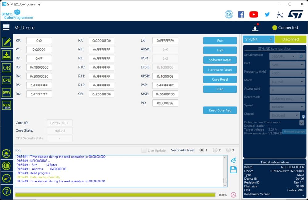

BBrow.2
Stepping it from RESET shows it stops at the GPIO command (str - 800024a)
 GPIOA->ODR = 0xFF;
 8000244: 2390    movs r3, #144 ; 0x90
 8000246: 05db    lsls r3, r3, #23
 8000248: 22ff    movs r2, #255 ; 0xff
 800024a: 615a    str r2, [r3, #20]
//  GPIOA->
R3 appears to be correct (48000000 is GPIOA address, 20 more is ODR address)

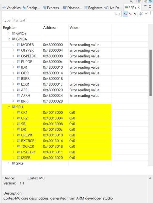

More specifically, GPIO is on AHB2 (Nothing else on AHB2), so it would seem that there is some kind of issue with AHB2 access.
BBrow.2
0693W00000WLFJmQAP.jpgCube IDE debug
BBrow.2
