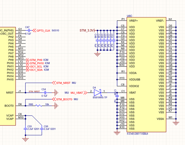

Here is my schematics:

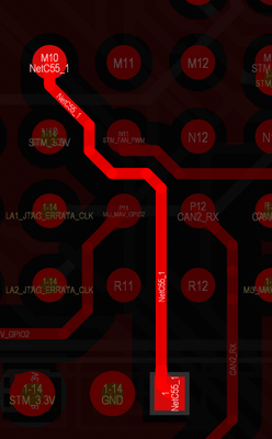

In my actual board, both VCAPs are not tied together. They are also not placed on the bottom of the board -- rather they are connected via a 0.1mm trace 3.5mm long to the edge of the BGA to the capacitor. Altium is saying this can carry 0.6A I guess impedance is bad and it might be the source of some of my issues (I can decrease the op frequency if so).
I also didn't place the bypass capacitors on the bottom of the board, but as the vias were there, I managed to add them manually (scrape soldermask on vias etc). It didn't make any difference I could see.
I'm really lost here. I think the issue must be hardware, but what should I try to fix it? I can't imagine a failure mode that fries the same GPIO on two boards and offsets HSI... But maybe the HSI is random and the GPIOs were fried by something connected externally -- aka the STM design is actually acceptable?

Design seems fine to me. Don't think anything there will affect HSI. Bypass caps should be 0.1 uF, not 1 uF. Probably fine, however.

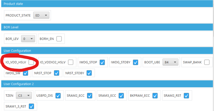

> PC1 is marked as HSLV but I'm feeding 3.3V to the STM so HSLV should be disabled (3.3V is set in CubeMX)
This too, may be prone to the click-to-code errors. RM says:
The I/O HSLV configuration bit must not be set if the I/O supply (VDD or VDDIO2) is above
2.7 V. Setting it while the voltage is higher than 2.7 V can damage the device.
So, what I'd recommend, is to double-check the HSLV-related fuses, and then write an absolutely minimal testing code, with no Cube/CubeMX involved, no clock setup (i.e. clocks at default) etc., setting up the GPIO manually, just the good old plain loopdelay blinky. HSI frequency can be checked through outputting it onto a MCO pin.
strulzl
Hey, I followed those recs.
Here are the option bytes showing HSLV is disabled:
And here is the simple code I'm using:
