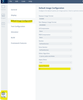

I followed the approach that was suggested in your response, and with the help of Copilot I was able to run several code reviews and test to isolate the root.
It turned out to be related to the image orientation handling in TouchGFX. The global default orientation was actually correct, but it wasn’t applied to the individual image entries. Each image — including button graphics — needs its own format and orientation explicitly configured. Since these per‑image settings are somewhat hidden in the UI, it was easy to miss.
I now have a working solution with only minor visual defects remaining. These will be the focus of further optimization and experimentation.

For the image rotation, each image can have its layout rotation parameter configured here:
If you select "default", it will use the layout rotation set in the default image configuration window:
