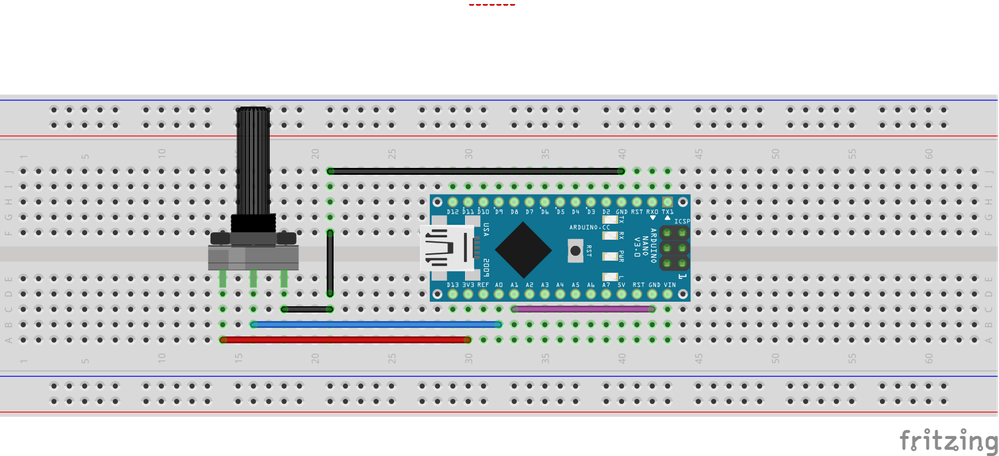

We're trying to read from the ADC from 2 channels by using EOC interrupts.
When we read the values seems like the channels are wired together.
As such we can't distinguish between whether they come from one channel or the
other.
Here is the code that we are using.
N.B. the Serial class is coming from the mbed framework.

Here is an example of the result we are having while we're moving the
potentiometer:

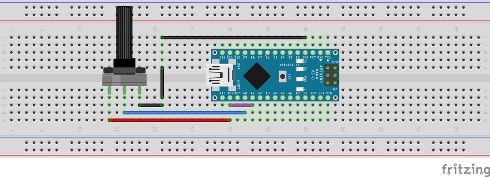

#A1 connected to 3v3
value1 0, value2 2746
value1 0, value2 2744
value1 0, value2 2745
value1 0, value2 2741
value1 595, value2 2831
value1 594, value2 2832
value1 593, value2 2830
value1 596, value2 2833
value1 593, value2 2835
#A1 connected to ground
value1 2143, value2 1721
value1 2515, value2 1590
value1 2642, value2 1280
value1 2642, value2 1279
value1 2642, value2 1282
Here are the wirings of the two configurations:
1 REPLY 1
jiangfan
points to check:
  • ADC clock may be too high ?
  • ADC sampling time too short ?
  • potentiometer value too high ?
ADC_SAMPLETIME_47CYCLES_5 - 47.5 cycles used, may try something like hundreds of cycles, or largest value. potentiometer like 10k ohm or less may be used to match the analog input impedance.
