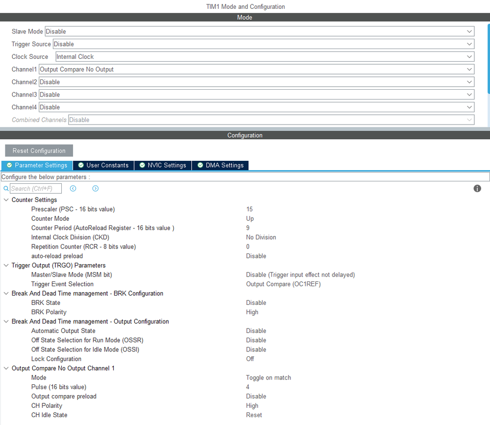

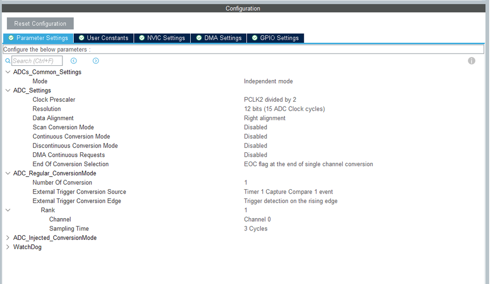

You can refer to the attached example that I generated using STM32CubeMx
in the ADC Configuration I only set the external Trigger to Timer 1 Capture Compare 1 event
_legacyfs_online_stmicro_images_0693W00000dDPjXQAW.pngThe Timer configuration is as in the screen below:
_legacyfs_online_stmicro_images_0693W00000dDPpGQAW.pngYou need to set the output compare No Output Channel 1 mode to Toggle on match
ps: I attached the project with the .ioc file

Thanks for reply.
I am using STM32f410RBT6 chip not bga.
I have checked my settings. They are the same as you provided.
But ADC still not working.
Maybe I am launching ADC wrong?
I enable ADC interrupt and call two functions.
HAL_TIM_Base_Start_IT(&htim1);
HAL_ADC_Start_IT(&hadc1);
I see that ADC interrupt is not triggered. Although TIMI1 is counting.
I see it in peripherals view on the Keil.
But no iterrupts of ADC are trigered.
waclawek.jan
June 8, 2023
You actually need to enable TIM1_CH1 output (you don't need to assign a pin in GPIO, but I don't know how does this work in CubeMX - if you assign a pin, you at least can check that the triggering signal works). This means that you can't use the "No output" selection and in TIM1 you have to enable also TIM1_BDTR.MOE.

Thanks to all for help.
My error was that i was using Srart_timebase function instead of HAL_TIM_OC_Start.
now it works fine
