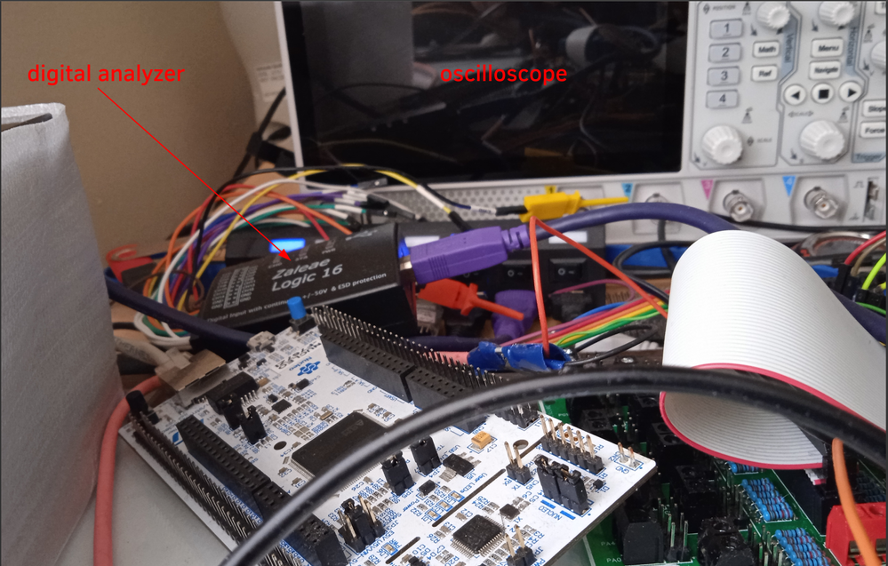

‎2024-01-18 2:42 AM
I checked it with a digital analyzer and an oscilloscope, see photo! The result is no signal with the same behavior on both devices.
I have a regular NUCLEO-F767ZI board that works perfectly if I create a project using the HAL library. However, when I try to implement a similar project using only registers, nothing works!

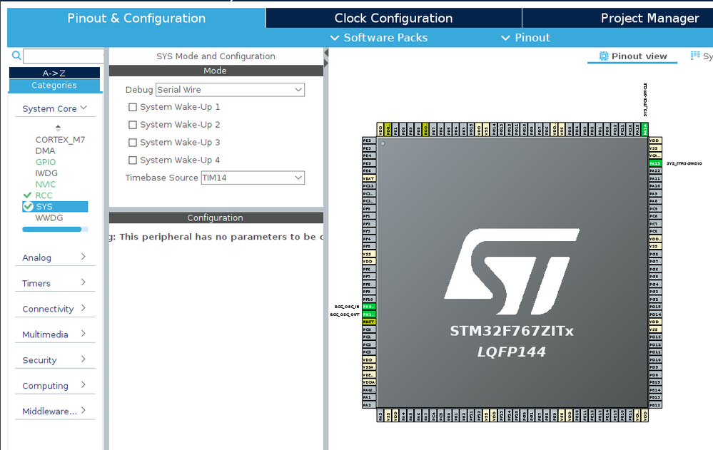

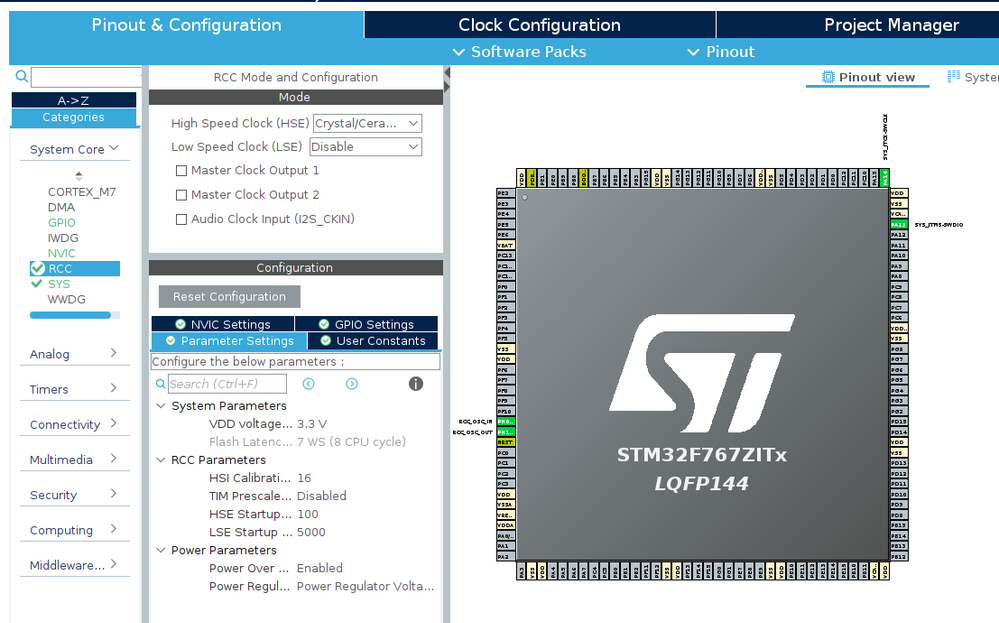

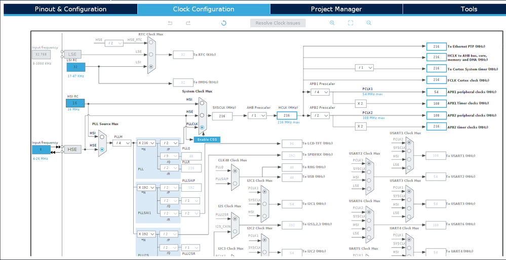

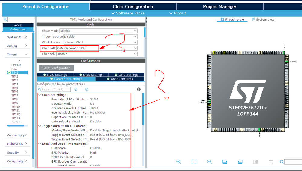

This is the first thing that comes to mind - just compare the registers from the working project on HAL and set the same ones in the project on the registers. That's what I've been doing, but I might be missing something! And if you look at millions of solution options on YouTube for BluePill and for the stm32f4-series, they all start working after the steps I mentioned in the first message. But that's not enough for the H7 series.
Question: Where are the macros or defines written that you configure in the window shown in the screenshot? Maybe if I set the necessary values there...
1. in main.c : MX_TIM1_Init ()
2. in stmxxxx_hal_msp.c : HAL_TIM_Base_MspInit () + HAL_TIM_MspPostInit ()
‎2024-01-18 3:51 AM
Thank you, I saw that, and this is for the project on HAL. But what should I do when my project is on registers? Should I write everything myself? You'll answer to me... To which I will respond, "Look at my first post," and that doesn't work! And I don't understand what I'm missing!?
