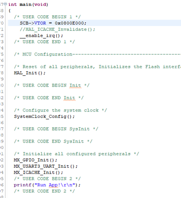

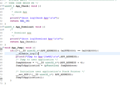

Used nucleo-h563zi board.Below is bootloader jump.
Below is app.
question:
I first download app through CubeIde,this code is run success,and every function is OK.But i reset this board,the code will enter NMI interrupt.

Instrument code more. Chek it reads proper / expected SP and PC values.
Step the transition in the debugger.
Make sure it is not trying to read unwritten areas of FLASH.
Check what SystemInit() does with SCB VTOR
