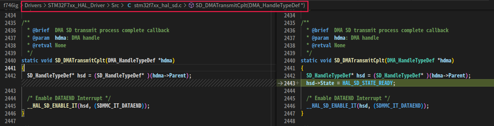

I found some bugs in the CubeMX generated code.
Does it forget reset the `state` after SDIO DMA TX? when I query the TX state by `HAL_SD_GetState` always get wrong result.

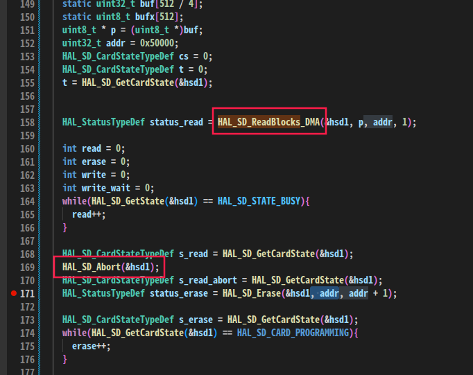

Dose SDIO DMA mode forget clear the transition state to SD card? when erase the block after a DMA read, it always failed, I have to put a `HAL_SD_Abort` after RX finished.0693W00000Y7dumQAB.png

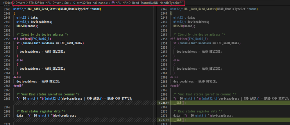

The follow code blocks forget `__DSB` sync instruction in function `HAL_NAND_Read_Status`, My MCU is stm32f746ig which with data cache, the origin version of code makes the MCU infinite loop.0693W00000Y7dv6QAB.png

In your last snippet, the file name is stm32f4_hal_nand_c, though your MCU is F7. How this happened?

sorry, I put the wrong file, but stm32f4_hal_nand_c has the same problem to stm32f7_hal_nand_c

The SDIO issue could be a bug or a similar issue to the one reported in this topic.
The NAND issue is a bug, but has nothing to do with a cache. Instructions can be reordered because the Cortex-M7 is a dual issue CPU and the respective NAND_DEVICE memory region by default is configured as a normal memory type. Read this article for a more detailed explanation. The solution - a single __DMB() macro between sending the command and reading the status (line 2368) is enough. And, of course, the same bug is present in F7 and H7 series HAL drivers.
