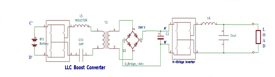

Hello Simon,
Let me tell you in detail. This will also an explanation of Andrew's question.
Please see the above block diagram of our application.
In our topology there are two stage. Stage 1 is of LLC Resonant Boost Converter to boost the Battery voltage at 380 V DC and Stage 2 is H-Bridge Inverter.
We use the same topology for 1kVA Inverter application.
Where we have used 36V battery as input and the boost voltage was also 380V.
We have successfully done this operation.
Now we are using this topology for 2kVA Inverter, where Nominal Battery voltage is 192V.
So we have started testing from 96V battery.
We have gradually increased Battery voltage like after 96V, the battery voltage is 108V, then 120V and so on.
So when we connect 120V directly to the input, microcontroller's operation got stopped.
One observation I would like to add that if we use diode bridge rectifier to create input DC of the LLC Converter and gradually increase the rectified dc Voltage by using Auto Transformer as the input of diode bridge rectifier, the problem did not raise.
But if we use 120V battery directly to the LLC Converter, the operation of the microcontroller got stopped.
Let us know if you need any further clarification.
Waiting for your response.
Thanks
GLASS
Senior
Hi.
Do you have galvanic isolation to drive bridges of stage 1 and stage 2?
May be it can avoid some parasitic return current​...
Same for debug probe​?
