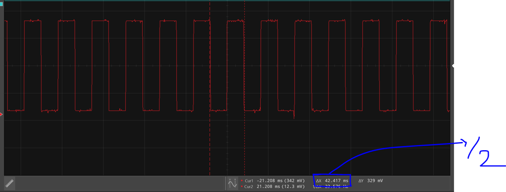

make the timer trigger an output channel gpio, then wire it to the ADC trigger input which will give you a signal to monitor or trigger for the oscilloscope. Make sure the trigger period is longer than the ADC conversion time...
Next, make the cyclical buffer bigger than what you need, more than double, so when you get the half transfer (half full) buffer, you have the time it takes to fill this half to perform the FFT before it's overwritten. toggle some GPIO to check how long the FFT takes (if doing continuously and not using a time sampling window).
Thanks for the reply, I've stripped down to basics to confirm my timer works. I'm using ADC_ConvtCallback to toggle a GPIO pin. and as you can see it roughly takes 20ms.0690X00000895hUQAQ.png One thing I do notice is, the buffer is filled when using DC values (connected a DC power supply) but when I connect a signal through a frequncy generator this isn't the case

Thanks for the advice. I've been busy with other parts of my project so I've been unable to work on this as often as I'd like. I've been doing some debugging and I can confirm the following:
  • The Timer triggers at the given period frequency which is good news.
  • The ADC also carries out a conversion and the length is in line with what I expect which is also good news.
I now need to work on coying the data to another buffer before perfoming an FFT. I'm currently using a CFFT as I will eventually be working with signals where I'll be interested in the phase which is why I've chosen to usee the CFFT module.
Any chance you are able to share your project online so I can use as a reference?
This was actually veryu helpful and helped me figure out my ARR and PSC values were double what I needed, thanks!
