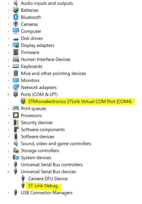

From my laptop: I saw it can connect to my laptop via ST-LINKS

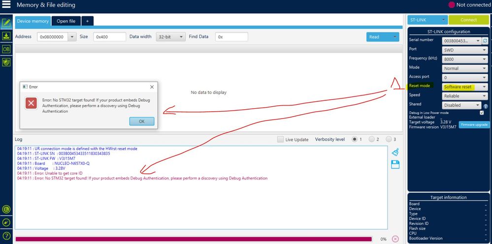

After that, I used the smt32cubeprogrammer tool and configuration for ST-Link as the second photo (Reset mode: Software reset), I received the error:
  04:10:41 : Error: Unable to get core ID
  04:10:41 : Error: No STM32 target found! If your product embeds Debug Authentication, please perform a discovery using Debug Authentication

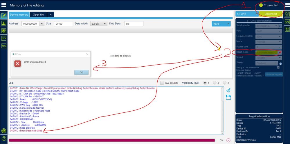

When I changed the reset mode to: Hardware reset, I received an error as Third photos:
04:20:12 : Error: Data read failed
In this case, I saw the tools can read the board stm32N657X0-Q, but it cannot access the memory.

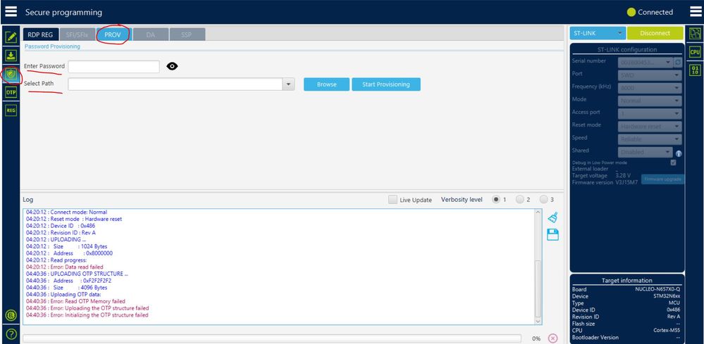

- Find root causes:
I read documents "stm32_debug authentication (DA)", stm32cubeprogrammer-user_manual, STM32N647xx STM32N657xx datasheet.
 After that, I suppose the error can be relevant by Debug Authentication for the board on the first time to use.

  4. While reviewing the Secure Programming section, I noticed it requires provisioning. Where can we input the passcode mentioned in the fifth photo?

Hello @Congtran90
I understand you are trying to etablish a SWD connection between NUCLEO-N657X0-Q and STM32CubeProgrammer.
Make sure that you are using the last STM32CubeProgrammer v2.18.0 version.
You need to change BOOT1 = 1 (JP2) jumper configuration to put the STM32N6570 in DevBOOT mode.This mode allow Debug port access by the bootROM.
You can refer to my post below and refer to the attached document (NUCLEO-N6570X0Q_Dev_BOOT.pdf)
https://community.st.com/t5/stm32-mcus-boards-and-hardware/nucleo-n657x0-q-failed-to-start-gdb-server/m-p/756600#M23206
Let me known if it solve your issue?

Dear RomainR,
I would like to thank a lot for your great advice and your suggestion,
Your solution is really helpful for me and my work, and that help me to solve the issues.
Yes, I am developing mode so I need to change connection in the JumpJ2 as your guide documents and then it works well,
Thank you a lot for your great solution and quick!
