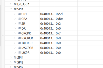

I am trying to init SPI1 (to just receive data qwith MISO) on nucleo G474RE without using HAL libraries.
Can you help me to assess why my code does not work ?
I can't see the clock eventhough SPI1 is enabled

So have you set the RXONLY bit?
Tommino
Senior
Thanks @Andrew Neil​
It was probably the RXONLY bit causing the issue. Now it is fine.

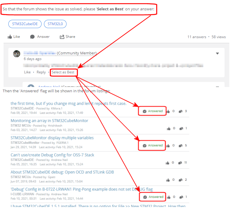

Good to hear - now please mark the solution:

SPI in its most basic form are two shift registers - one for output one for input - and some control logic to generate clocks.
If SPI is set as master and enabled, and then you write to DR, the control logic generates 8 or 16 (or whatever you set) clocks on SPI, and using those clocks it shifts out data from output shift register to MOSI and shifts in data into input shift register from MISO.
If you don't assign any pin to MOSI in GPIO, well simply the internal MOSI output from SPI module is connected nowhere and the shifted out data are lost. If you don't assign any pin to MISO in GPIO, the internal MISO input to SPI module is set to 0, so you will simply receive all zeros.
The mode which is set by RXONLY bit is already an extension to this basic model - if you set that bit, as soon as SPI is enabled, the control logic starts to generate clocks and it won't stop until SPI is disabled.
