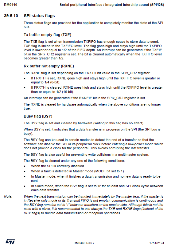

I am trying to init SPI1 (to just receive data qwith MISO) on nucleo G474RE without using HAL libraries.
Can you help me to assess why my code does not work ?
I can't see the clock eventhough SPI1 is enabled

@Tommino "How is this prevented?"
There'll be a status bit that tells you when a transfer has completed.
On this chip, you also have read & write FIFOs
