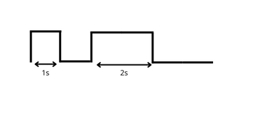

Hi everyone,
In my project, I try to create a TTL signal generator, and I found a useful function that uses DMA on PWM signal (HAL_TIM_DMABurst_MultiWriteStart), so that I can create arbitrary rectangle signal that I want.
I am using a timer frequency of 90 MHZ (32 bits timer)
Let's say I want this signal with a prescaler =0
0693W00000NsnFeQAJ.pngI tried this code with no success I have no result in my oscilloscope
uint32_t buffer32b[6] = {90000000, 0, 45000000, 180000000, 0, 90000000};
  HAL_TIM_DMABurst_MultiWriteStart(&htim2, TIM_DMABASE_ARR, TIM_DMA_UPDATE, buffer32b, TIM_DMABURSTLENGTH_3TRANSFERS, 6);
  HAL_TIM_PWM_Start(&htim2, TIM_CHANNEL_1);

Can you please help me?
5 REPLIES 5
waclawek.jan
Read out and check/post content of TIM and relevant DMA and GPIO registers.
Okay but it doesn't help me
waclawek.jan
How do you know?
CCR1 and ARR are not updated when I debug and look at registers
Strangely, when I write this function it works CCR1 get updated
