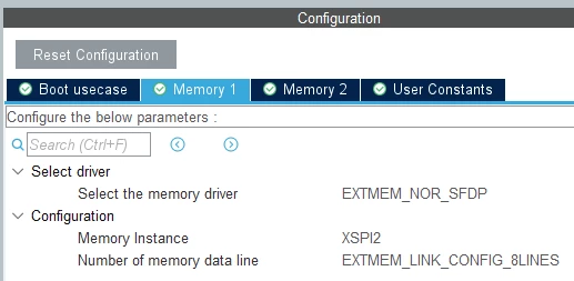

So, I'm starting with the template_XIP project in the STM32H7S78-DK Firmware package.

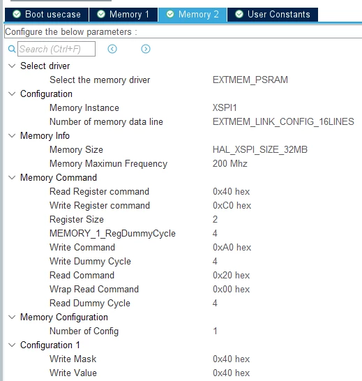

The .ioc file there has the external memory manager has memory 1 set to the onboard NOR flash in XSPI2.
Memory 2 is configured as PSRAM, for the external PSDRAM chip on the DevKit:

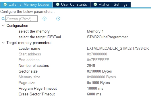

The EXTMEM_LOADER is pointed at Memory 1, configured above, for executing code:

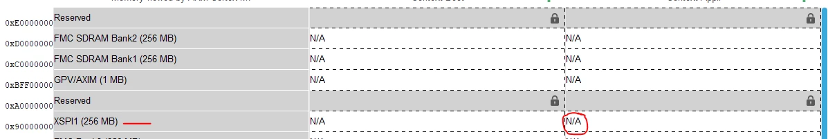

The SPI Configuration is default from the template, with MMT settings unchanged.
This does not allow the PSDRAM to show up in the memory management tool, and I don't think it gives me direct access to it in my application, to make arbitrary writes to memory addresses. This is my goal. I'd just like to write to the external ram chip like it's any other chunk of data memory.

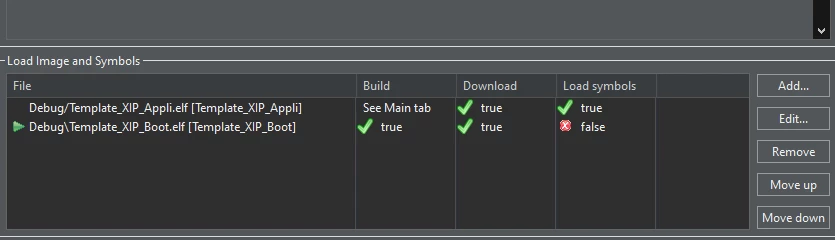

The code generated from this project compiles and debugs, if you apply the same settings to the debugger as are in the example .project file. Setting bootloader as the first code that runs, then jumping to application code, with bootloader selected.

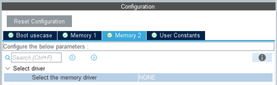

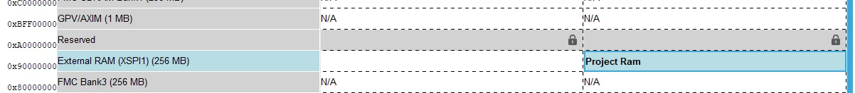

First, on the EXTMEM_MANAGER, I set Memory 2 to "NONE"

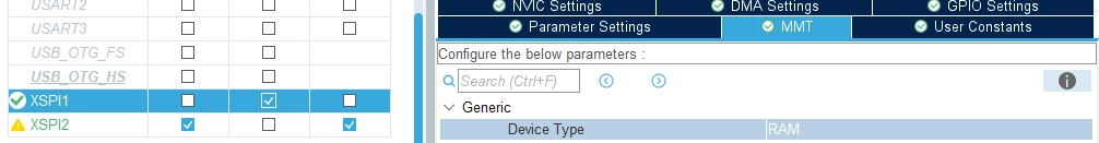

Then, I remove XSPI1(PSDRAM) off of bootloader and onto application.
Also, set the MMT Device type to RAM.
After this, external RAM shows up in the memory management tool, and I'm able to allocate it as I'd like.

In STM32Cube IDE, the project builds fine. All the same debug configurations are applied:

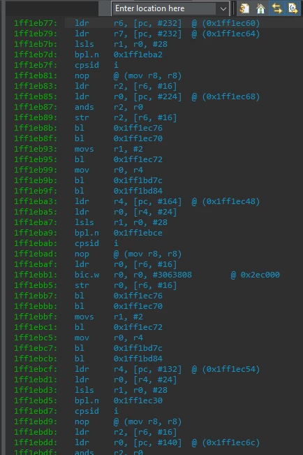

Now, the issue when I debug or try and upload this, is this error:
With this Disassembly:
My Questions:
If I had to guess what was going on, It seems like The external memory manager needs a place to execute code from that is fast. I thought that the application instructions in external flash would be loaded into AHB or AXI ram on chip before they would be executed, but it seems to me like they are really getting executed from external PSDRAM. Which I could be totally off base, but if that is not the case, what is the purpose of the Memory 2 section of EXTMEM_MANAGER? I guess it could be putting the ram in some kind of pool for malloc() or something, but it seems silly that I don't have an address for it that I can just write too, unless it's dedicated for instructions.
