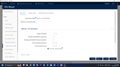

I am using a Nucleo-F446RE board with the x-nucleo-ihm07m1 driver, to control a LA052-040E servomotor.
Comment that I have not been able to generate the motor profile with the ST Motor Pilot Tool (profiler) V1.2.9.
Which comes with the MotorControl Worbench 6.3.0 program,
After connecting the device and clicking start, the connection is reset and the board is disconnected from the application.
But with the Motor Profiler 5.4.8 version. Yes, it generates the engine profile for me.
Once the parameters have been entered, the position control application works, but I do not obtain all the desired power.
The current consumed from the supply is 200mA and the motor supports up to 2.5A.
I have the board configured for 1A as the maximum current.
The driver supports 1.4A constat current.
How can I increase the power of the engine, I need it to have more strength. I think he is not giving his full potential.

Sorry. I do not know if I explained well.
The motor is configured with the main Observer+PLL sensor. Without enabling the hall sensor or the encoder.
The program does not work. It is disconnected from the communications port.
