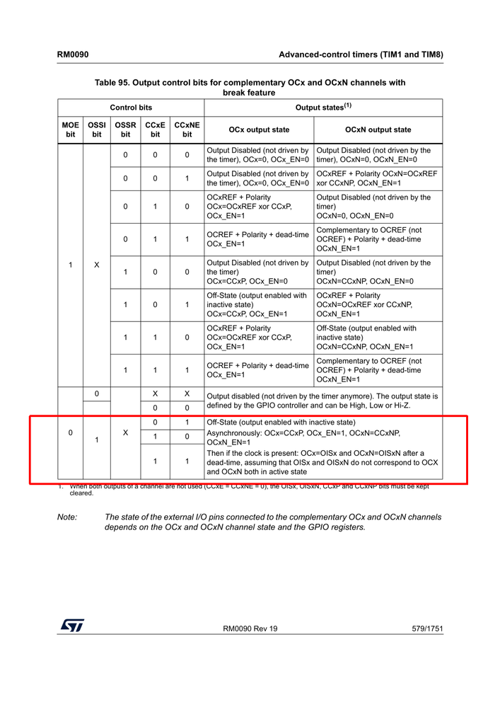

A more sophisticated option is to utilize MOE and OSSI (and OISx/OISxN) in the Advanced timers:

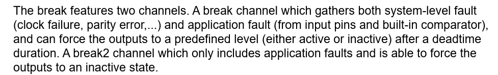

i would use the break feature of tim1 .
set break output state/levels as you like and then , when set brake by software, all outputs go to this state immediately .
