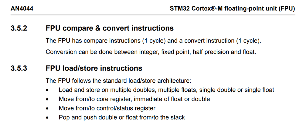

I come back to this old discussion and would like to mention that the FreeRTOS context switch routine is generic to any Cortex M4 with FPU. Here is an example how to save/store FPU registers in addition to lazy mode.
Added to that, ST provides this application note AN4044 section 3.5.3 FPU load/store instructions where we explained load/store instructions.
Also, in Cortex-M4 Revision r0p0 Technical Reference Manual, you can find cycles counts of each instruction set.
It would be a good enhancement for our application note to include and detail the vpush/vpop instructions as load/store option for FPU. These instructions can potentially reduce the timing of FPU save/restore operations. (Any use case proposal from your side is welcomed, you can share your example privately if possible)
