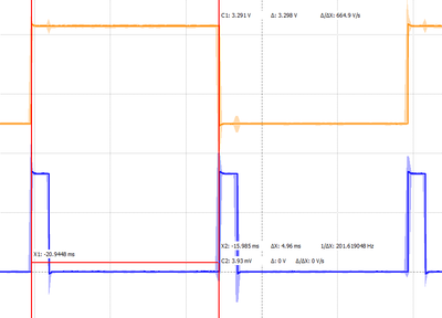

I want it to work as a ping-pong buffer for MDMA. Tried doing a SW trigger of the DMA Ping pong buffer, but was too slow.

The case is that I want to sample with 5 Msps and 8 bit resolution. When a trigger is called, I need 40 ms of data = 200 000 B, and store it on a SD card. The trigger should stop all ADC and DMA actions.
Before the trigger is called I will need to continuously store the last 40 ms of data. The DMA is limited to 64kB due to the counter. So I need to copy the data in the DMA buffers to a bigger buffer without loosing any data. I tried to copy data in SW by reacting to the SW interrupt of the DMA. But the new interrupt came before all data was copied, eg. data lost. Maybe I have performed this the wrong way?
‎2023-12-13 09:14 AM
Certainly, copy data should be faster than ADC 5 MHz conversion clock, can say for sure.
‎2023-12-13 12:08 PM
It worked! It was alot faster! Had to just figure out why my interrupts acted strange, and the software version got fast enough.
Blue is Time to copy.
Orange toggles between half full and full interrupts.
