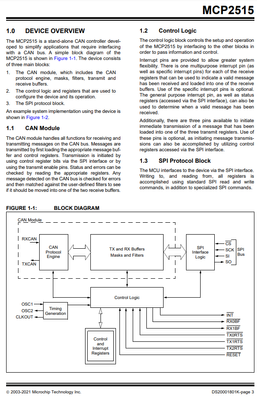

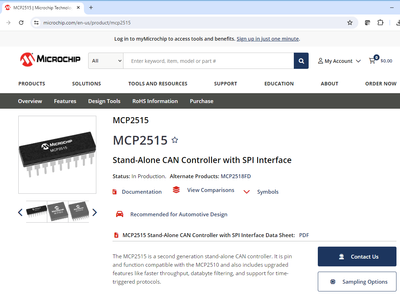

As it says on the tin, it's a "Stand-Alone CAN Controller with SPI Interface" - not "ISP".

It's the MCP2515 which does the "conversion" between CAN and SPI !
You'll need to start by studying the MCP2515 documentation:
https://www.microchip.com/en-us/product/mcp2515
