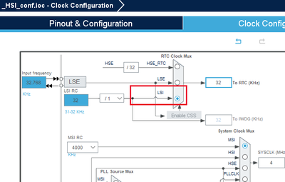

I would like to know if it's possible to configure my evaluation board HSI, I have this code and I would like to adapt it on my evaluation card and see if it is compatible with the rest :

2024-12-20 5:29 AM
> Thank you but your answer is not very precis, did you see my projet.zip ?
I saw your zip file. Did you see my answer?
As I said, you will have to use LSI as a clock source to something if you want CubeMX to enable it. Otherwise it is not needed and will not be enabled.
2024-12-20 5:33 AM - edited 2024-12-20 5:49 AM
@Andrew Neil wrote:You said you'd made changes since the zip file you posted.
Yes it's the case with my _HSI_conf project (in projet I have the .ioc file) but I don't have the same code. What I would like to obtain
RCC_OscInitStruct.OscillatorType = RCC_OSCILLATORTYPE_HSI
| RCC_OSCILLATORTYPE_HSI48 | RCC_OSCILLATORTYPE_LSE
| RCC_OSCILLATORTYPE_LSI | RCC_OSCILLATORTYPE_MSI;
And with _HSI_conf project I have this code :
RCC_OscInitStruct.OscillatorType = RCC_OSCILLATORTYPE_HSI48|RCC_OSCILLATORTYPE_HSI
|RCC_OSCILLATORTYPE_LSE|RCC_OSCILLATORTYPE_MSI;
I'm missing the RCC OSCILLATOR TYPE LSI line
2024-12-20 5:48 AM
@TDK wrote:As I said, you will have to use LSI as a clock source to something if you want CubeMX to enable it. Otherwise it is not needed and will not be enabled.
Always very vague and evasive, nothing concrete. Can you modify my .ioc file in my _HSI_conf projet and show me the generated code ?
And I have this code
|RCC_OSCILLATORTYPE_LSI|RCC_OSCILLATORTYPE_MSI;
And this is the code I am waiting for :
I'm missing the RCC_OSCILLATORTYPE_LSE line
