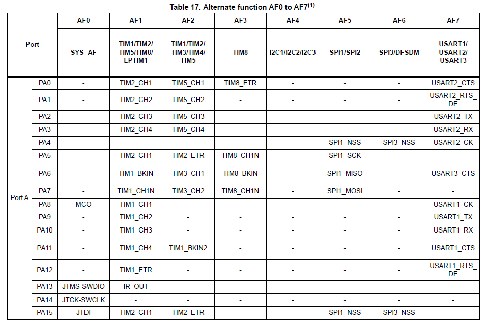

I have a very straightforward question but I am not able to find the answer in the user manual. I am using the L476RG nucleo board and setting the TIM5 registers to output a PWM. How can I select the output pin? Is it fixed or does it have some degree of freedom?

The datasheet provides this information, especially tables 16 and 17:
0693W00000KbSu1QAF.pngSo you need to select the right GPIO alternate function to have PWM of TIM5 available on a GPIO pin.
In your case You need to configure AF2 as shown in the table above.
You can refer to the example provided in STM32CubeL4 under the path Projects\STM32L476G_EVAL\Examples\TIM\TIM_PWMOutput : especially the file stm32l4xx_hal_msp.c in which GPIO pin of PWM output is configured.
