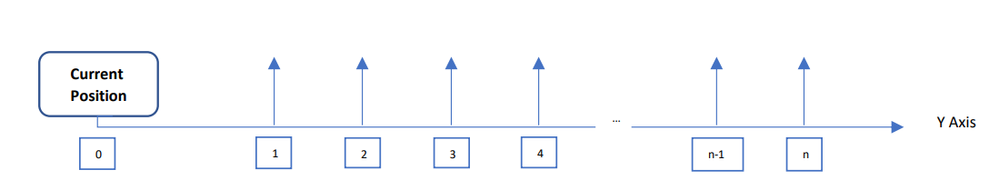

My application needs to generate pulses on specific encoder position like this :
I was able to setup TIM2 Channel 1&2 in encoder Mode, TIM2 Channel 3 Output Compare (no output) as master to TIM1 Channel 1 in One pulse Mode.
I can trigger the first position but now I'm trying to update TIM2_CCR3 register so at next position TIM2 Channel 3 can trigger TIM1.

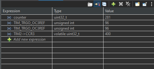

but next position doesnt produce a pulse output then tried forcefully
htim2.Instance->CCR3 = NextEncoderPosition;
again still no output, I tried the "soft" way shown in
void HAL_TIM_IC_CaptureCallback(TIM_HandleTypeDef *htim)
I thought maybe I can't access TIM2->CCR3 register in that callback function (for some reason),
so I tried updating TIM2->CCR3 register in main... still no pulse output on that encoder position.

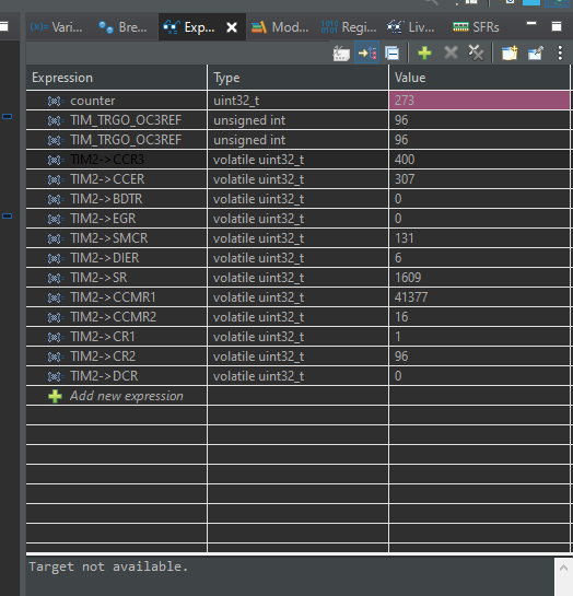

TIM2->CCR3 Register does get updated with __HAL_TIM_SET_COMPARE(&htim2,TIM_CHANNEL_3,400);
but I guess I am missing another Enable register or flag or something.
DPatr.2

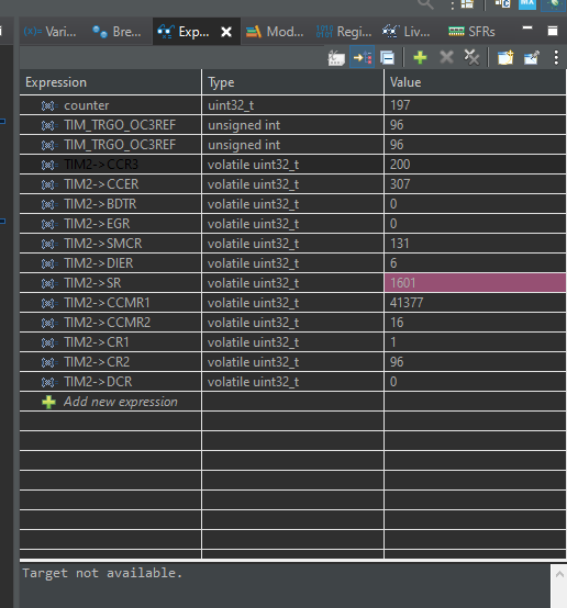

Continuing the adventures into TIM2 registers, here's what I found :
TIM2->SR has 1601 value in before I get to first trigger position
TIM2->SR has 1609 value after first trigger position.
0693W00000KbT2UQAV.pngI will study some more of this SR register but it seems like if I overwrite 1601 in it after updating CCR3 should work.
