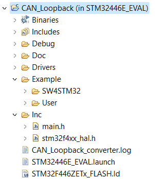

Imported an example code of CAN loopback on STM32F446RE board,
Please guide me to check the signal in DSO(hantek Software),
I do not have a CAN analyzer please help me to get the signal in digital oscilloscope.

As I understand you want to visualize the CAN frame using an oscilloscope. Using this firmware: Projects\STM32446E_EVAL\Examples\CAN\CAN_Loopback you can visualize CAN frames sent on CAN_Tx pin.
