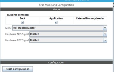

I’ve been trying to run an SPI loopback test, but my code gets stuck in the transmit function. The data never actually transmits, so the function waits indefinitely. When I checked the SPI clock pin with a logic analyzer, it remains low. I also verified the peripheral clock in the SFRs, and it shows that the SPI clock is enabled.
For the hardware setup, I connected MOSI to MISO with a jumper wire.
I’ve attached images and included the full code—please take a look and help me figure out what’s causing the issue. One more note: I’ve used the same configuration in previous projects and it worked fine, but now it suddenly doesn’t.
If the information I’ve provided isn’t clear or sufficient, I apologize—please let me know, and I can share more details.

Yes,The pin toggles even tried using a different spi
Did you set it full duplex master ? (for transmit - receive )

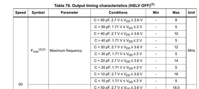

and set pin speed to medium..or more:
- you have it at low speed, but want transmit 18Mbit...
and set keep io state, for constantly using the line:
