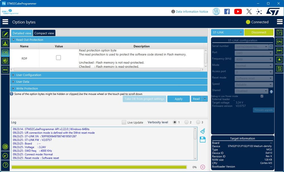

I'm looking at setting the RDP Level to Level 1 for an STM32F103 and I don't see the AA BB CC type stuff like in the current manual. Is this something that STM32CubeProgrammer is doing on purpose for this MCU?  I definitely don't want to enable Level 2 by accident and brick my chip.  Here is a screenshot of what I see:
CubeProgrammer RDP Checkbox.jpgIs it safe to check this?

In STM32F10xx (first STM32 series), the flash protection was simple. No RDP levels 0, 1 and 2. Only RDP activated / RDP not activated.
Please refer to PM0075.
So yes you can check it to protect the flash from reading.

Thanks for the reminder to check the data sheet (and doing so on my behalf). The internet is a dogs breakfast. Even here, simply skimming topics can be, um, insufficient.
Introduction
STM32F1 microcontrollers offer three levels of read-out protection: level 0 (no protection), level 1 (Flash memory, backup SRAM, and backup registers protected), and level 2 (same as level 1, but with permanent protection by locking the option bytes). It's important to note that level 2 should only be considered for the final product, not during development stages.
https://community.st.com/t5/stm32-mcus/how-to-change-the-read-out-protection-on-stm32f1/ta-p/49408

To me STM32F10x has only two levels Level 0: no read protection, Level 1: read out protection enabled. (unless I'm missing something).
Even in the driver (stm32f1xx_hal_flash_ex.h), two levels are available:
/** @defgroup FLASHEx_OB_Read_Protection Option Byte Read Protection
#define OB_RDP_LEVEL_0            ((uint8_t)0xA5)
#define OB_RDP_LEVEL_1            ((uint8_t)0x00)
@Grant Bt
Contacted the knowledge base article owner and confirmed the issue: No RDP level 2 on STM32F10xx
The article will updated then.
So my answer is valid.
