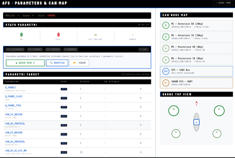

I'm new here, but i have worked on a flight controller unit FCU with those:
FMU Processor: STM32H753
IO Processor: STM32F103
This FCU then connected to a Raspberry Pi4, auxiliary, where  run his drone python software, using MAVlink approach for telemetry data and CAN communication and parameters setup;
Right now
We have a (good) software ready, with some wizard working well
BUT
we have an issue with CAN-motors and our STM chips...
Is it possibile that those H753 is NOT able to read a CAN motor ,brand new, out of fabric?
or better
Is the chip (H753) ABLE to write a NODE ID on a CAN motor, wich is ut of fabric (nodeID=1) to an actual working NODE ID(10,11,12 etc..)?
We had this issue....
based on your knowledge..
The correct way is to use a CAN-USB to "wake up" motors one by one and then connect to FCU?
Thank you

Hi everyone and thank you for reply;
Quick reply so we dont miss the point:
My Flight Controller Unit with STM32H753....look like that is not "able" to recognize a brand-new motor(with NodeID=0 or 1) and SET this NodeID=10-11-12-13 etc...so the Node for actual working on the drone...
All the other parameters (telemetry, MAVlink, CAN managemnt too)...look like saved and verified on the FlightControlelrUnit board...but if we try to use this X6 to set that NodeID written on the ESC itself...this X6 with STM chip look like is not able to...(TMotors esc..look like need they need this https://en.tmotor.com/uploadfile/2024/0801/20240801044215937.pdf)
Now i have not this cloudlink,i 100% need this? i dont think so...
We have this USB -CANable (open source-look good-not yet tried...)
To solve this NODE-ID problem:
The idea now, quicly, is to:
  1. connect both: this USB-Can, and the X6 FC Unit...to our auxiliary Rapberry
  2. Running python software wizard , wich use MAVlink to comunicate with X6 (with STMSTM32H753 chip)
  3. Once verified paramaters loaded and telemetry (this work)...
  4. python start a ESC Node Wizard: the user connect to this USB one-motor at time...the wizard use this USB-CAN to write the correct code to ESC...then wizard pass this new written motor to the X6 (STM32H753)...this X6 now recognize the correct NodeID, and bind definetly to the motor
  5. This wizard setup, x4 motors
>> We need to do this becouse look like that X6 (STM32H753) is not able to SET this correct NODE-ID from 0/1 (out of fabric) to 10-11-12-13(funcional)...
You have same issue? Look quite absurd to me, but we have done diffenret test and setup...using this wizard tools we have done a step-by-step procedure that miss no human error...but with only the X6(STM32H753)...we fail and now tying with usb

>is complex.....i think that you CAN-trace, will be our CAN-ESC-wizard, reading inside the ESC of single motors, setting up NodeID and then bind it tho the actual flight system sofware...
>the idea was to map all ginle motors and do 1% speed, 5%...and so on..but right now we are not able to define this becouse of this NON-MATCHING-NODE IDS, i cannot setup up a correct CAN protol manager on the sofware...
for having an idea...This is the drone/params wizard tool we developed.
Thank you for your help
We will try and update here
