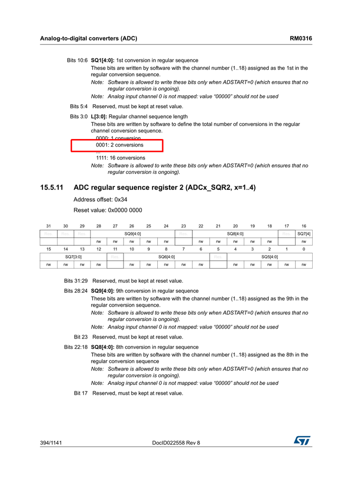

I am currently trying to set up a minimal example of using DMA for ADC conversions on a NUCLEO-F303K8 development board. I'm using the CMSIS device headers rather than the HAL, so I apologize if my issue is due to misunderstanding something in the reference manual.
I have been able to set up the timer and ADC to regularly trigger the ADC interrupt on end of conversion and read the data, but I have been unsuccessful in implementing the DMA equivalent -- triggering a DMA transfer on end of conversion directly to RAM. I have been receiving DMA full transfer interrupts as expected (on the timing interval + conversion time), but the ADC reading transferred by DMA is garbage.

Using DMA results in adc_reading jumping around 0xFFF - as if my analog input voltage was at the analog supply voltage or saturating. Using the ADC interrupt results in adc_reading holding the proper converted value, for example 0x800 at half analog supply voltage.

This is a genuine mystery.
I see absolutely no problem with the code (but did not try to run).
Which STM32 exactly and what hardware?
Is VREF+/VREF-/VDDA/VSSA (if applicable) properly connected and rock stable?
If you try to read out ADC_DR in the DMA ISR, what's the result?
Other things to try, although most probably of no help: symmetrical PSIZE and MSIZE, non-circular DMA, larger buffer.
I am using the STM32F303K8T6 on a Nucleo board (reference board MB1180.) According to the schematic, VDDA is connected to VDD at 3.3V from the on-board regulator and VSSA is connected to ground. The lines look stable as far as I can tell.
Reading out the data register in the DMA ISR gives the same value as stored in adc_reading.
Symmetrical PSIZE and MSIZE did not seem to have an effect, but I did get some progress by changing adc_reading to a buffer of size 2:

Now, adc_readings[0] contains the correct reading on every DMA transfer, and adc_readings[1] contains the same garbage value as before. I'm afraid I don't understand why this is occurring, and while it works, I wouldn't consider it a solution. Any ideas on what else I can try? I will try to run the same setup on a different board to see if it is some obscure hardware issue.
Now it makes sense!
Thank you very much! I figured it would be a detail I overlooked. Works flawlessly now.
