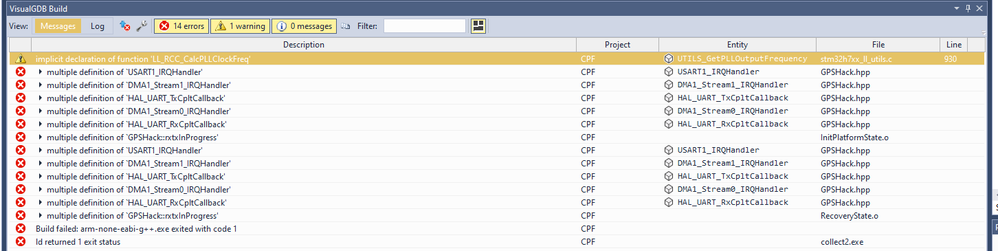

I have a file in my VisualGDB project that has all the HAL code necessary to talk to a GPS receiver through a UART. I can #include this GPS file in one of the other files in my project and the code in that file can talk to the GPS just fine. If I #include the GPS file in a second file in my project, all the IRQ Handlers throw multiple definition errors like this:
Error  multiple definition of `USART1_IRQHandler'
Shouldn't the #pragma once directive prevent this? Seems like there must be a way to make the UART code visible in multiple files in my project that I haven't figured out yet? I've been looking for an example project or library that uses the STM HAL stuff in a project that's broken up into multiple files but haven't been successful yet. At some point, I realize I'm going to have to dump the STM HAL code and do it myself but I'm hoping to delay that as along as possible.

There's probably another definition of USART1_IRQHandler in your code somewhere. CubeMX will generate one and put it in the hal_*_it.c file. The linker error message should provide more info on where it's first defined.
To use a variable in multiple source files, it need to be declared in a common header, or, declared in one source file and declared as "extern" in the other one you want to use it in.
Using HAL functions in multiple source files shouldn't be an issue as long as you're including the headers, which you are.
You should not use #pragma once in source files, only headers. But that's not an issue here.
Would be better to post the full error message you're getting.

Header files which are to be #included must not contain function/object/variable *definitions*, only declarations.

@TDK - Here's the full error

USART1_IRQHandler is not defined or declared in stm32h7xx_it.c. I actually can't find the declaration by searching for USART1_IRQHandler. This subroutine is the only other place I find a reference to USART1_IRQHandler but I don't really understand what it's doing.

USART1_IRQHandler is defined in startup_STM32H7b3xxq.c as weak, naked. If I don't define my own USART1_IRQHandler, my program will compile and run but jump here and tell me I need to define my own which is what I'd expect.

> GPSHack.hpp
Ah, so it's a header file. As JW says, you can't have definitions in a header if that file is included from multiple source files. Split it up into a header with declarations and a source file with definitions.

magene
Senior II
That worked! @TDK​  and @Community member​ , I'll be happy to buy each of you the drink of your choice the next time you're in the Monterey Bay, California area. Or several drinks. Many, many thanks.
