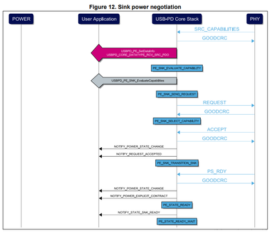

I am currently using the STM32U585 MCU on a custom board and am trying to get the MCU to function as a DRP device in the USB-C PD protocol. Although currently I am just trying to get the device to work as a SNK (with DRP capability enabled). The project I am implementing this in is using ThreadX as the RTOS.
I have followed multiple tutorials for getting USB-C power delivery implemented on ST MCUs and have implemented the needed changes in the CubeMX .ioc file and have also made the necessary changes in the code listed in AN5418.
I have also referenced plenty of example projects including: DemoUCPD, USB-PD_Consumer_1port, USBPD_DRP_UX_DRD_HID, USBPD_SNK, and USBPD_SNK_UX_Device_HID_CDC_ACM.
One thing that is worth noting is our custom PCBs do not have the TCPP IC on our board, contrary to a lot of the examples. Also, a lot of examples also seem to use FreeRTOS, but the rest of our project has been using ThreadX, so didn't want to make the switch.
Here is what I have found so far, using this flow diagram as the expected sequence of events in a Sink Power negotiation:
-Device gets through initialization and reads the VBUS voltage correctly.
-When a USB-C cable is plugged in (USB-C to USB-C cable with USBPD capable power source) the program is able to enter the USBPD_DPM_SetDataInfo, but instead of entering with a USBPD_CORE_DataInfoType_TypeDef of USBPD_CORE_DATATYPE_RCV_SRC_PDO, it enters with USBPD_CORE_DATATYPE_RDO_POSITION and then with a subsequent call with USBPD_CORE_DATATYPE_RCV_REQ_PDO. It then repeats this a second time with nothing happening. This doesn't match the flow in the picture above.
-USBPD_DPM_SNK_EvaluateCapabilities is never called.
-I have used both the STM32 UCPD Monitor and a Cypress USB-PD monitor. All I see is that my device only ever sends zeroes back. I can see the USB-C power source sending the correct messages so I can confirm that the power source is working.
-Using a breakpoint in the code I can see that the code enters USBPD_PORT0_IRQHandler and correctly enters UCPD_SR_RXMSGEND when the USB-C cable is plugged in. I can also see a byte being received in my buffer, but can only see one byte at a time since that is the size of the UCPD RX register.
-I tried to look at the memory location where I would expect to see the full message received, but I only ever see zeroes (potentially a DMA issue?).
I have looked at multiple example projects and most of them seem to have the same file content between them. Since the SetDataInfo callback is being called with reasonable parameters and the IRQ handler is getting to RXMSGEND, I assume that we are possibly receiving data correctly, but I could be wrong.
I have tried just using the application in SNK mode rather than as a DRP, and I have gotten the same results.
Any help or hints would be greatly appreciated.

Update: Found that the program was entering into USBPD_DPM_SetDataInfo on the two instances listed above, and then it enters PORTx_IRQHandler and enters the RXMSGEND if statement. Still no data in memory.
cd3361Author
January 22, 2025
Also, noticed that the GPDMA IRQ Handlers (for USBPD TX and RX) have no code generated within them. Although in a lot of the other example projects there is no code generated in the handlers, so maybe this is intentional and not a bug.

Hi @cd3361
The GPDMA IRQ handlers are empty, and this is intentional, since the DMA transfer is being handled by HW in pooling mode.
When debugging, you can check transfer complete flags in GPDMA_C3CR are all set to zero which means they are not in interrupt mode.
Would you check which example is using FreeRTOS?
USBPD_DPM_SNK_EvaluateCapabilities function evaluates the received capabilities and decides which power profile to request. In your case you may have only one power profile, USBPD_DPM_SNK_EvaluateCapabilities should be added to establish the first contract.

Hi @cd3361
I couldn't reproduce on our reference board B-U585I-IOT02A - Discovery kit for IoT node with STM32U5 series - STMicroelectronics
Please check your hardware implementation, maybe the TCPP missing is the root cause of this issue. To understand better the issue, would you attach a trace (.cpd file) to analyse further? My first impression the source capabilities are not properly received. To be checked!
In usbpd_dpm_user.c, USBPD_DPM_SNK_EvaluateCapabilities  is meant to evaluate the received capabilities and prepare the request. It seems like something is missing. Would you attach your project? or simply a direct link from github.

Hi @cd3361
The source sends its capabilities. However, your sink device sends NOT_SUPPORTED messages and initiates SOFT_RESET. Check your sink PDOs list. The sink device is not properly handling the received SRC_CAP.

Awhile back I was able to get the USBPD_DRP_UX_DRD_HID (uses ThreadX) example working with the STM32H573I-DK and this is what the sequence looked like:
Can see that after SRC sends its capabilities the SNK (dev kit) sends a GOODCRC. Whereas on my board it just sends 0x0 back (one tool called this a C_RSVD0 message and the other called it an Unknown_CONTROL_ID message).
Regardless if my board couldn't support the capability, shouldn't it follow the Source's capabilities with a GOODCRC message?

Hi @cd3361
You could have your definition of SNK PDOs covering various voltages and power. At the end, whatever those PDOs, decision about which SRC PDO to choose to build the REQUEST message is a SNK decision.
Entry point of this selection/decision in ST provided examples is the USBPD_DPM_SNK_EvaluateCapabilities function. You might feel the need to update SNK PDO, in order to request the "right" SRC PDO, as current example implementation is looking for a "best match" between received SRC PDOs, and defined SNK PDOs. To learn more check this.
To conclude @cd3361 , the example provided should be working. Potentially, you have an in issue in your hardware, custom PCB, so your parts being used after reset blocks the hard reset message (which explains why source can't see it) ? ... Maybe the sink would like to send a hard reset. but if nothing is coded, no way the source can see the message.
