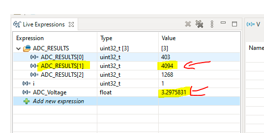

Hi All,
I am working on ADC with multiple channels Interrupt method using
NUCLEO -L4R5ZI- P(STM32L4R5ZITxP). ADC working for all channels irrespective of GPIO Pins.
for example, I Commented GPIOA( Port A and its clock) highlighted in bold color even though the ADC channels of Port A works.32 MHZ clock selected for ADC here.
Can Someone please help me , how to work with ADC only by selecting GPIO Pins.
7 REPLIES 7
Kiran kumar

I do verified by connecting the Potentiometer to ADC Channels and it works for all the channels even though GPIO pins and its clock enabled or disabled.
How to configure ADC Channels should work only by selecting GPIO Pins and its clock ?

ADC_CHANNEL_X ( X -> 1,2,34.........16) all are working without the initialization of GPIO pins.
We are getting the digital values for every 0.8mV ( 3.3/2^12). vref is 3.3 and 12 bit resolution. we verified it by connecting Potentiometer to the ADC_CHANNEL_2 .
Is the ADC_CHANNEL_X ( X -> 1,2,34.........16) enabling the GPIO pins internally ?
What is the default mode of ADC Pins ?

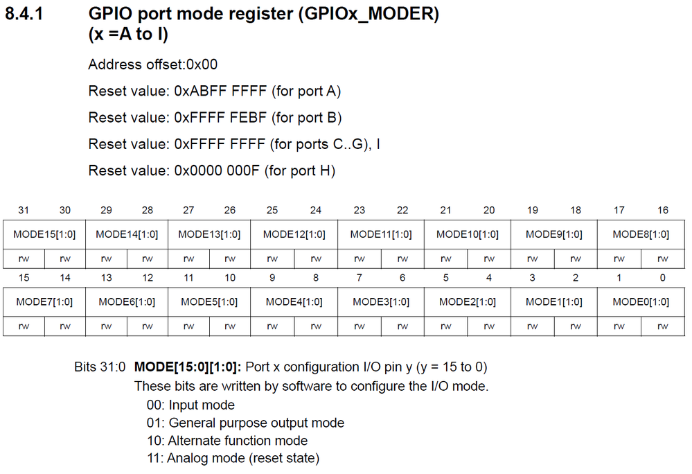

The default mode of pins is given in the reference manual under the relevant GPIO register settings.
For this chip and other newer chip families, most pins are in analog mode after reset. That would explain what you're seeing.
