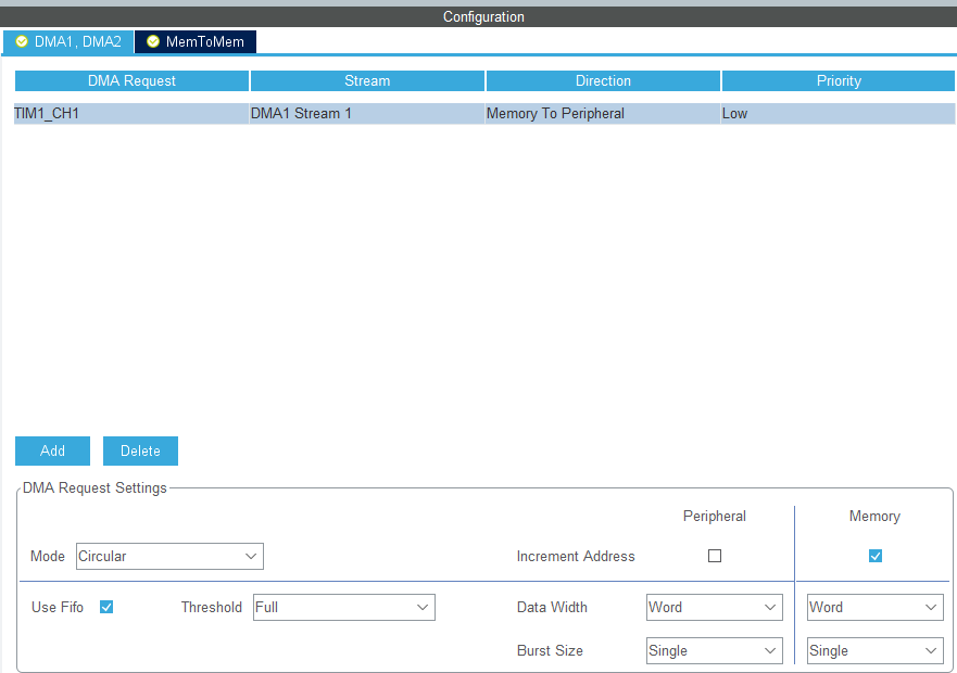

I am trying to use DMA to control GPIO port E output.
Below is configuration of CubeMX
In Cortex-M4 context of dual core , DMA is successfully working to toggle GPIO Port E output .
But In Cortex-M7 context of dual core , although error message, DMA is not working.

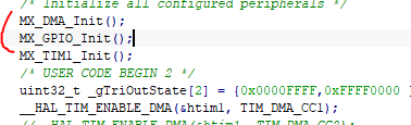

Hello @hryu.1​ and welcome to the Community :)
Please update the line MX_DMA_Init(); before MX_GPIO_Init().
This is a known issue (when using CubeMx v6.3.0) with the DMA initialization which should be before any other peripheral initialization .
This limitation will be fixed in the next release of CubeMx.
Hope this solve your issue.

‎2021-11-02 1:20 AM
as you suggested, I did it. But it is not working in Cortex-M7 .
is it impossible technically to use DMA1, DMA2 in Cortex-M7?

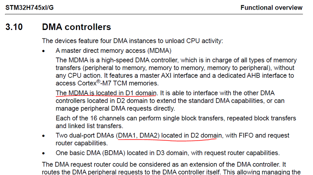

‎2021-11-02 1:35 AM
Do I use MDMA instead of DMA1,DMA2?
If i have to use this,Please, let me know how to use it?
STM32H745xI/G datasheet ​
‎2021-11-02 1:43 AM
The problem is maybe related two things: memory layout on STM32H7 and internal data cache (D-Cache) of the Cortex-M7 core.
Please have a look at this FAQ: DMA is not working on STM32H7 devices.
I'll be waiting for your progress=)
