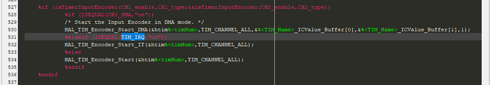

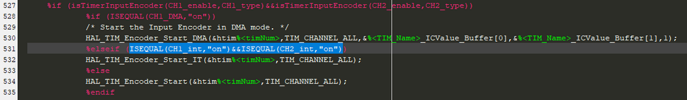

- there are a Bug in the TIMER_config.tlc at line 531. When i use the timer in encoder-mode, it generate always an ISR but it is not configurated. When I'm change the following line everthing works fine. Compare the pictures below.
this is also correct: ISEQUAL(CH1_int,“on“)&&ISEQUAL(CH2_int,“on“)&&ISEQUAL(TIM_IRQ,“on“)
