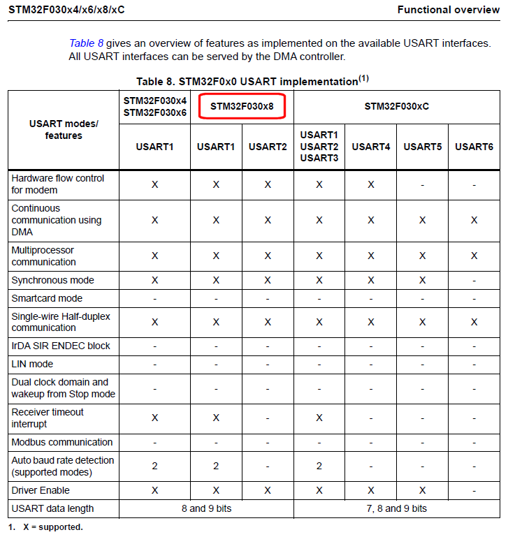

Did you mean STM32F030x8?
Datasheet has no mention of any hardware FIFO for the USART:
0693W00000QKw6GQAT.pngSo you'd have to implement any FIFO (aka "Ring Buffer" or "Circular Buffer") in software.
Since it's in software, it wouldn't be specific to the STM32 - there are plenty of general resources on implementing circular buffers

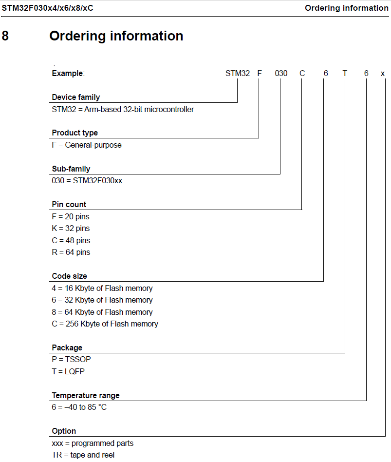

@SSRIN.2​  "stm32f0308"
Again, that's not a proper part number - please give the actual part number

@Andrew Neil​
''Again, that's not a proper part number - please give the actual part number''
part number is STM32F030R8T6
