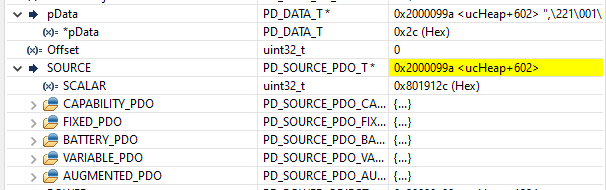

The issue is triggered when reading from a pointer variable SOURCE with is a union of bitfield type.
This seams to be working
POWER->PowerSource = SOURCE->CAPABILITY_PDO.PDO_TYPE;
08002a78: ldr r3, [r7, #28]
08002a7a: ldrb r3, [r3, #3]
08002a7c: lsls r3, r3, #24
08002a7e: lsrs r3, r3, #30
08002a80: uxtb r3, r3
08002a82: sxtb r2, r3
08002a84: ldr r3, [r7, #24]
08002a86: strb r2, [r3, #16]
But this fails to execute
PD_VOLTAGE_T VoltUnits = SOURCE->FIXED_PDO.VOLTAGE_UNITS;
08002aa6: ldr r3, [r7, #28]
08002aa8: ldr r3, [r3, #0]
08002aaa: lsls r3, r3, #12
08002aac: lsrs r3, r3, #22
08002aae: uxth r3, r3
08002ab0: str r3, [r7, #20]

‎2021-04-15 3:49 AM
Which STM32 part? Alignment issue?
Sure it's not trying to Hard Fault?
.CPP file, or compiling as C++?​
‎2021-04-15 3:53 AM
Part is STM32G071
This is C only and I believe compiling as C only
Hard Fault caused by? When commenting this phrase its working fine.

‎2021-04-15 4:55 AM
In Cortex-M0/M0+, you must meticulously obey alignment. Typecasting pointers is one good way to arrive at unaligned positions.
Here, it appears to me, that pData is word-unaligned already.
Learn how to debug hardfaults, it's a useful skill.

‎2021-04-15 5:33 AM
This is how the debugger shows the variables
‎2021-04-15 5:34 AM
‎2021-04-15 7:33 AM
This, the CM0(+) does not permit spanning 32-bit read/write access, other CM families will tolerate misaligned LDR/STR, but not LDRD/STRD
In your code example both [r7] and [r3] memory accesses must occur on 32-bit (4 byte) address boundaries.
If sizeof(PD_SOURCE_PDO_T) is ODD, the first set of data might work, the second set will not.
0x2000099A fails the alignment test
Suggest also you implement a proper Hard Fault Handler that can output diagnostic info. I've published these multiple times to the forum.
