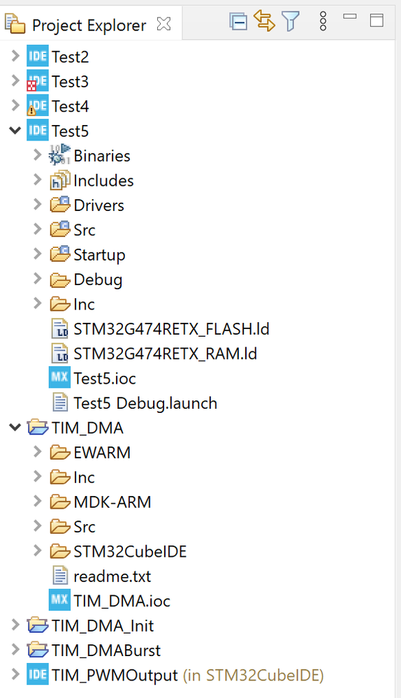

Has anyone had any success generating sinusoidal PWM with DMA, on STM32G474? The same code that I implemented on a STM32F series does not work. Also, the ST example for this board, related to this topic, TIM_DMA, does not run as it has binaries missing.

‎2021-04-14 9:37 AM
That was the first thing I tried, but the example does not compile. Anyhow, I found the solution to my problem; the DMA should be configured as word instead of halfword.
