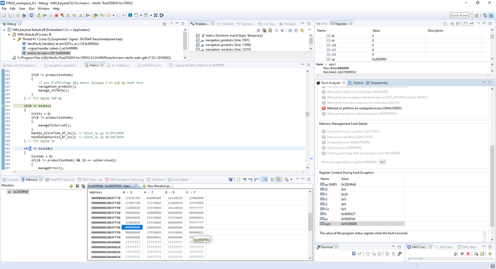

Hi all,
Thank you for your advices.
Here is a print screen of micro's state the last time Hard Fault happened:
I will also check hardware with my colleague tomorrow, and keep you in touch.
Best regards
‎2021-02-11 9:24 AM
You want to look at the code disassembly to put the register content in context.
Are the values here volatile, are they flagged in a TIM or SYSTICK interrupt.
Does behaviour change if optimization level dropped?
