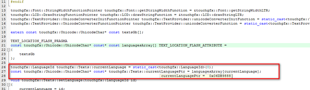

Place assert In external Flash.When load the "TextFlashSection",which place fonts in exteral flash,an hardFault occured.
cyneer
Hi,all!
I'm Using STM32f767 developing touchGFX applications .Using MDK5.
By the following the guidence in "https://touchgfx.zendesk.com/hc/en-us/articles/205886201-Placing-Assets-in-Flash-Memory" placing the fronts in extern Flash.
sct file config as the following codes:

With the mapped address begin in 0x9000 0000,the Font pointer should get an adress at 0x9000 000 uper.However, the font point get the location 0x6DB 9888, not in the extera flash.
then I get a HardFault.
the same Application no using Inner Flash get the address at 0x080861C8,the it can run the GUI Demo without any question.

Hi @cyneer​,
How did you create your project? Something looks like QSPI hasn't been properly initialized at the time the language array is read.

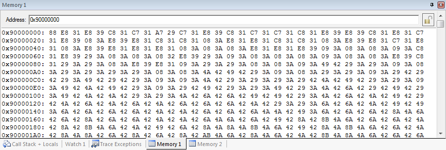

I think the QSPI peripheral did working cause I enable the QSPI memory Map model,when I don't use the part access area for fonts, the application can run normally.
While I usd Debug model, data in memroy mapped address at 0x9000 0000 is the same as the result when I use normal SPI operation to read.

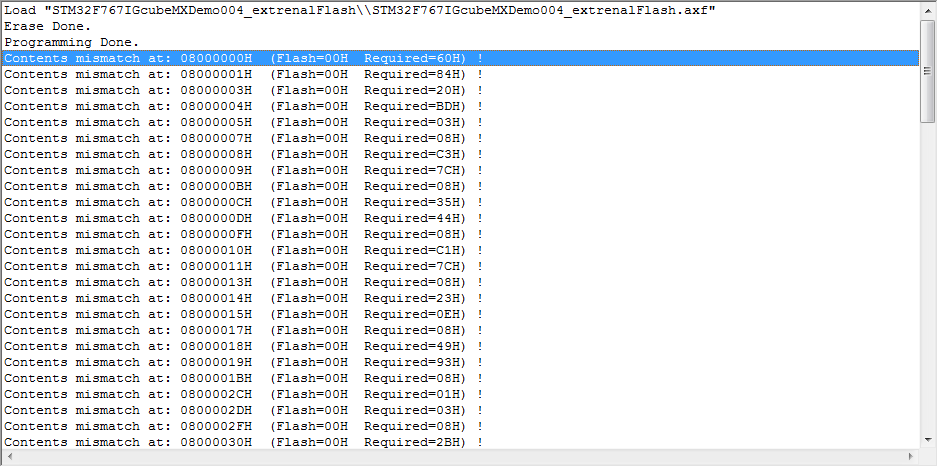

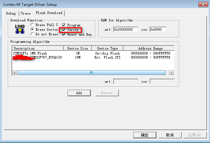

Incidentally,I write the MDK "Flash Programming" to place asserts by myself ,but some thing wrong happend .This lead to download and flash failure.
when I don't use the "verify" option,the the codes down load successfully.
I check the QSPI driver and finally found what cause the problem is address mapped error when opprate the external flash!
