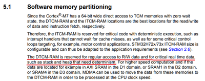

I agree with @Tesla DeLorean the execution will be slower but the cache could compensate that at a certain level. The best location to locate the stack/heap is the DTCM for execution determinism. You can refer to the AN4891 "STM32H72x, STM32H73x, and single-core STM32H74x/75x system architecture and performance" / Section 5.1 Software memory partitioning :
