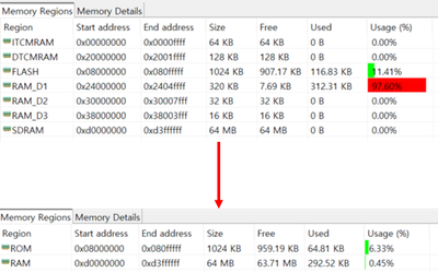

All internal RAM has been used to implement the current application.
Additional feature implementation requests require variable allocation and access to external RAM.

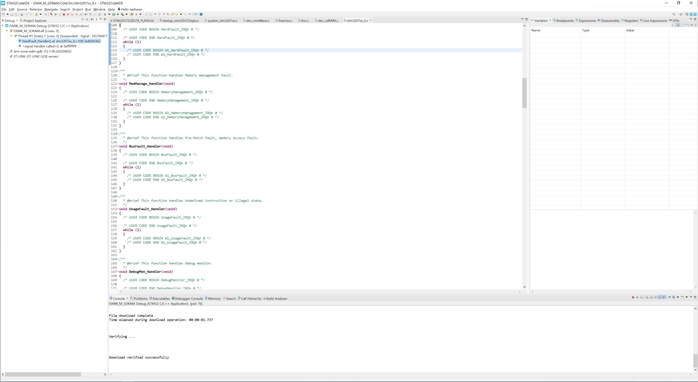

I reviewed the STM32CubeH7 example and applied it to my project, but encountered a HardFault Handler.
(Modify STM32H747XIHX_FLASH.ld file in my Project)
Please let me know if there is anything else I need to check.

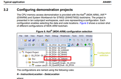

Also there is an example how to locate the global variables in the external SDRAM in x-cube-perf-h7  related to the AN4891 STM32H72x, STM32H73x, and single-core STM32H74x/75x
system architecture and performance
Look at the project config 6 where the code is executed in ITCM and all variables are located in SDRAM:

Your SystemInit() code needs to bring up the clocks, PLLs and SDRAM so code in startup.s can initialize the statics. Doing it in main() is too late.
The HardFault_Handler indicates that the memory you are touching is not functional.
