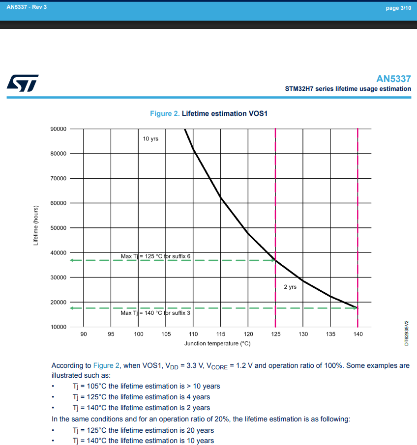

I came across this document here https://www.st.com/resource/en/application_note/dm00622045-stm32h7-series-lifetime-estimates-stmicroelectronics.pdf
We have a H75x custom board running the MCU in VOS1 at 400MHz with external 1.2V core power supply.
According to this description here
According to Figure 2, when VOS1, VDD = 3.3 V, VCORE = 1.2 V and operation ratio of 100%. Some examples are
illustrated such as:
• Tj = 105°C the lifetime estimation is > 10 years
• Tj = 125°C the lifetime estimation is 4 years
• Tj = 140°C the lifetime estimation is 2 years
In the same conditions and for an operation ratio of 20%, the lifetime estimation is as following:
• Tj = 125°C the lifetime estimation is 20 years
• Tj = 140°C the lifetime estimation is 10 years
the power consumption, heat dissipation and lifetime is influenced by "operation ratio". What does operation ratio mean and how can I influence/control it? Does this mean that only a part of chip silicon is powered/used? Or time spent in the idle loop, assuming the MCU is running in lowest VOS mode and/or clock frequency during idle time?
I would expect this term to mean the relative time of the system operating at given temperature.
Higher temperatures and higher currents cause electromigration (migration of n-/p- doping atoms), which degrades the die structures over time.
Mind you, these are all statistical measures.
And second, the key temperature here is Tj, not Ta.

So this:
https://www.st.com/resource/en/application_note/dm00622045-stm32h7-series-lifetime-estimates-stmicroelectronics.pdf#page=4
Indeed, the term "operation ratio" is vague and needs proper definition.
I guess it's some sort of "duty cycle": presumably, the 20% indicates the proportion of time operating at the high junction temperature - but what is happening in the other 80% of the time?
Presumably it would also depend on how long the high temperature is maintained?

I tend to agree with you. After all, this is one of those documents that create more questions than give answers... :)
I wonder what happens to the chip if lifetime is over? MCU clock stutters (but nobody cares about), flash bits are worn out, chip goes up in flames, ...?
So the primary goal in order to save lifetime is to keep the junction temperature below 125°C?
This can be acchieved via power consumption reduction and chip cooling. Latter is hard to do.
Power consumption is proportional to MCU core voltage, clock frequency, active silicon, ...
But is switching VOS levels, frequency and turning on/off temporarily unused peripherals really a practical way to go in an industrial application? I guess most applications nowadays are still running a super loop at VOS0. What happens? Never heard about failing systems due to running at CPU maximum clock speed. Is this only STM business?

Statistics, indeed. For example, what means "lifetime > 10yrs"? 0.01% of samples are damaged after 10 years?
I wonder how we can guarantee that the chip lasts >10 years. What does ST recommend their automotive customers? Run the chip at VOS2/3?
If all depends on junction temperature, how can we measure it? Is it possible to calculate junction temperature from chip chassis temperature? Or calculate it from MCU power consumption? Any easy/practical way to do so?
I guess H7 has an internal temperature channel, but IMHO it has a huge offset and must be calibrated.
In our design the chip is only a couple of °C higher than ambient temperature and I wonder what must be done to make the chip junction temperature rise to a temperature > 100°C. Run the board in a closed isolated chassis at 100°C?
The document refers to the H7 family. Some have a SMPS feature. Does it make a difference to juction temperature if core power is provided by LDO or by external power supply? I guess if powered from LDO the chip is heated up.
Many processors have an internal temperature sensor
@Andrew Neil wrote:
Yes indeed, and I just checked the H723 ref manual:
> 29.4.31 Temperature sensor
> The temperature sensor can be used to measure the junction temperature (Tj) of the device.
If what I see from the internal temperature sensor is half-way close to the real Tj, then I am quite relieved with my typical application:
  • Tj is at about 15°C above Ta
  • single core running at 400 MHz
  • audio streaming via ethernet at about 25 Mbps mostly via DMA
  • CPU awake about 20% (checked quite precisely with CYCCNT)
Looking at the graph above and estimating Ta max of 50°C, this should work for at least 20 years. :D
