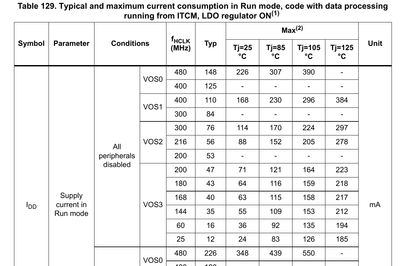

Just see ds , what this kind of chip process doing at high temp:
At 105° you get 550 mA !!! THIS it cannot survive many years.
In this table you see the strong effect of the ambient, so having +40° makes a big difference.
But if ambient not so hot and speed not at max , no problem:
my H743 with all peripherals i need runs at 83 mA , about +4° over ambient.
So the real current consumption and the resulting heat on chip is the indicator, will it get a problem - or not.
This table shows the effect of ambient? Do you mean that current @ Tj=25°C is, for example, measured at Ta=0°C and Tj=105°C is measured at Ta=60°C? The higher the ambient temperature, the higher Tj and the more current is drawn by the chip? How do you explain this effect?

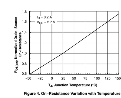

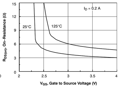

Just look at ds of a single mosfet, or any transistor...junction temperature changes almost all parameters.
And -right- its own activity produces loss = heat, so its parameters change also with activity or switching.
hot -> bad on-resistance
hot -> resistance + switching-level -> more bad

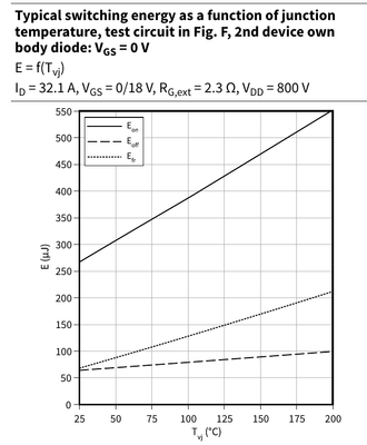

switching loss 25° -> 175°  about 300% increased  !
So same speed switching produces up to 300% more heat at same switching speed, if chip hot !
