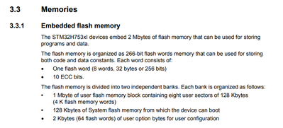

Page 25 says 2KB of user option bytes. Can this be used in someway? I couldn't find memory map address or APIs regarding this.
Thanks
Datasheet - STM32H753xI - 32-bit Arm® Cortex®-M7 480MHz MCUs, 2MB flash, 1MB RAM, 46 com. and analog interfaces, crypto
No, they can't be used and are not user accessible. The datasheet should be changed as it's misleading.
